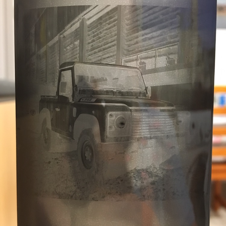

Developed it tonight - came out fine except for dark (light) edges to both sides of the negative evenly throughout the roll. It was also it bit speckly throughout. Not sure what caused that.

Here is a pic of the negative

I bought a few rolls of R100 a couple of years ago and every one looked exactly like this.
as Ian says, age

Thanks for looking Ian! I was concerned it was me (I loaded the film in broad daylight!).
as Ian says, age
It obviously doesn't like being kept for a long time! I half thought it might be alright, as it was in a foil pack and box and had been kept in a dark loft since at least 1995. It was a good practice for loading 120 film into the spiral though, it went in quite smoothly.
A loft unless insulated has big temperature and humidity swings, and is the last place for storage of film or cameras.
Thanks Xmas, I didn't fully explain, but the point of the exercise was practice loading 120 film into a spiral. I thought I'd use this instead of potentially wasting new film. Any images produced by it was always going to be a bonus!
Ok but I'm still using film from last century and only have problems with a higher base fog level.
You might have been ok with better storage.
Efke did warn about acid stop and recommended hardened stop bath or fixer.
