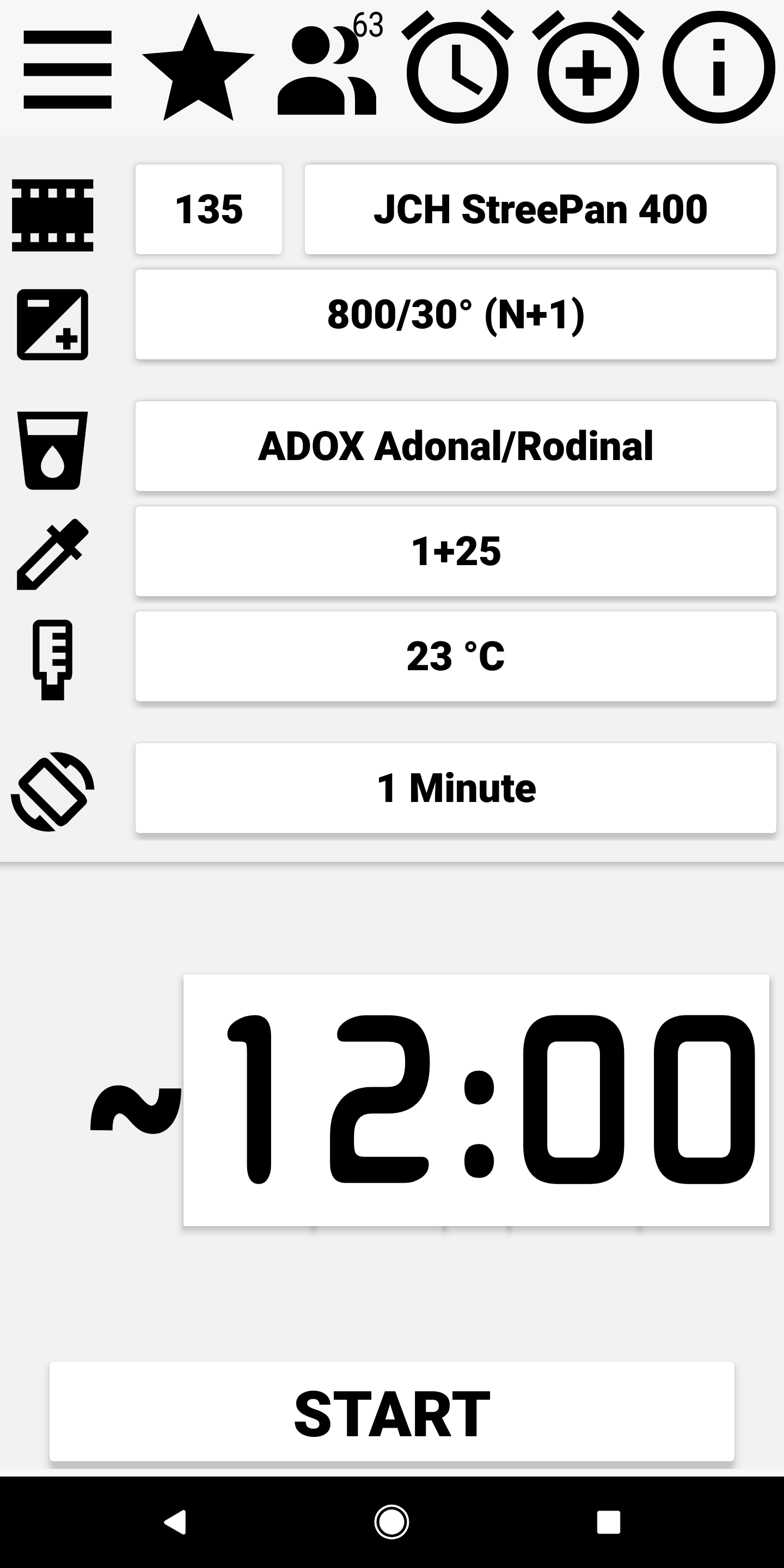

Hi guys, new here and very new to film.developing.
I usually shoot in 800 iso so when I got some JCH 400 I did the same ... Not reading much about it and not seeing that it's only recommended up to 500.
I looked for info and used the massive Dev app, but there was no timing information for this film at 800, it just want an option.
So I used the Film Developer Pro app as it had the JCH profile and would let.me select 800.
I developed in Rodonol at 1:25 for 12 minutes at 23c
...and the negatives were under developed. So so badlyso the timing was totally incorrect ncorrect, can anyone help me with Dev timings for this film at 800 iso? I can't find any information anywhere and still have ten rolls of this at 800 (which I won't do again). I wish I knew how to calculate this stuff myself.
I use Rodinol, Xtol and Microphen -hoping to find for all.
Thanks for any assistance.

Hey there, thanks for the reply. Yes I used that chart (the app is the same thing)...that's the problem. it's missing everything for the 800 timings for all the developers that I use (rodinal, xtol and.microphen)
Thankyou very much for the info, it's helpful. I am after high contrast as thats the look I usually.go.for,hence why I shoot at 800 a lot..jch is so new to.me and developing is new also ...is there a formula I can use to.l calculate the 800 range from the 400? I know it's not as simple as doubling the time..
A lot.of the.detail is there,.I'm sure, the neg at the time in the attachment are practically.light grey ... Which points me to underdevelopment ...
Not sure exactly how to proceed - maybe add a minute or two to the calculated formula and try find the sweet spot, but as a newbie that worries me haha
