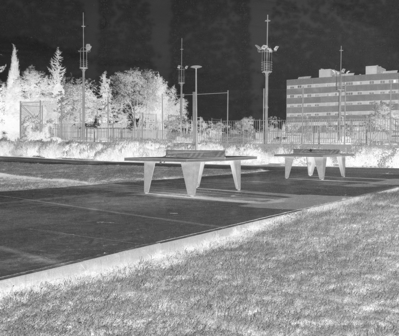

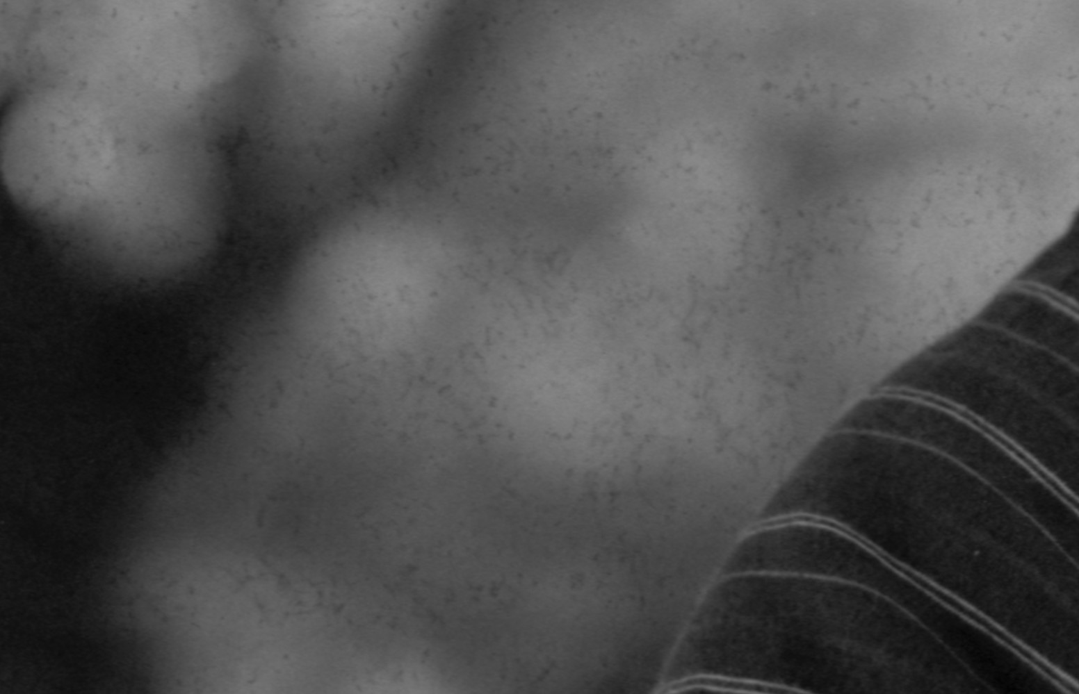

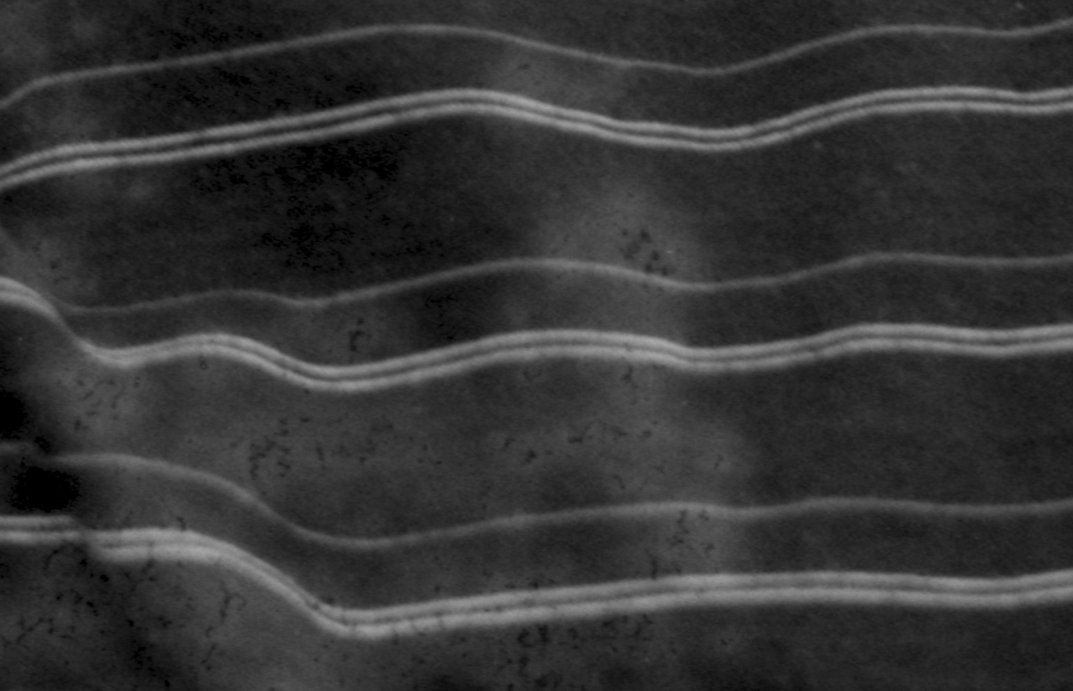

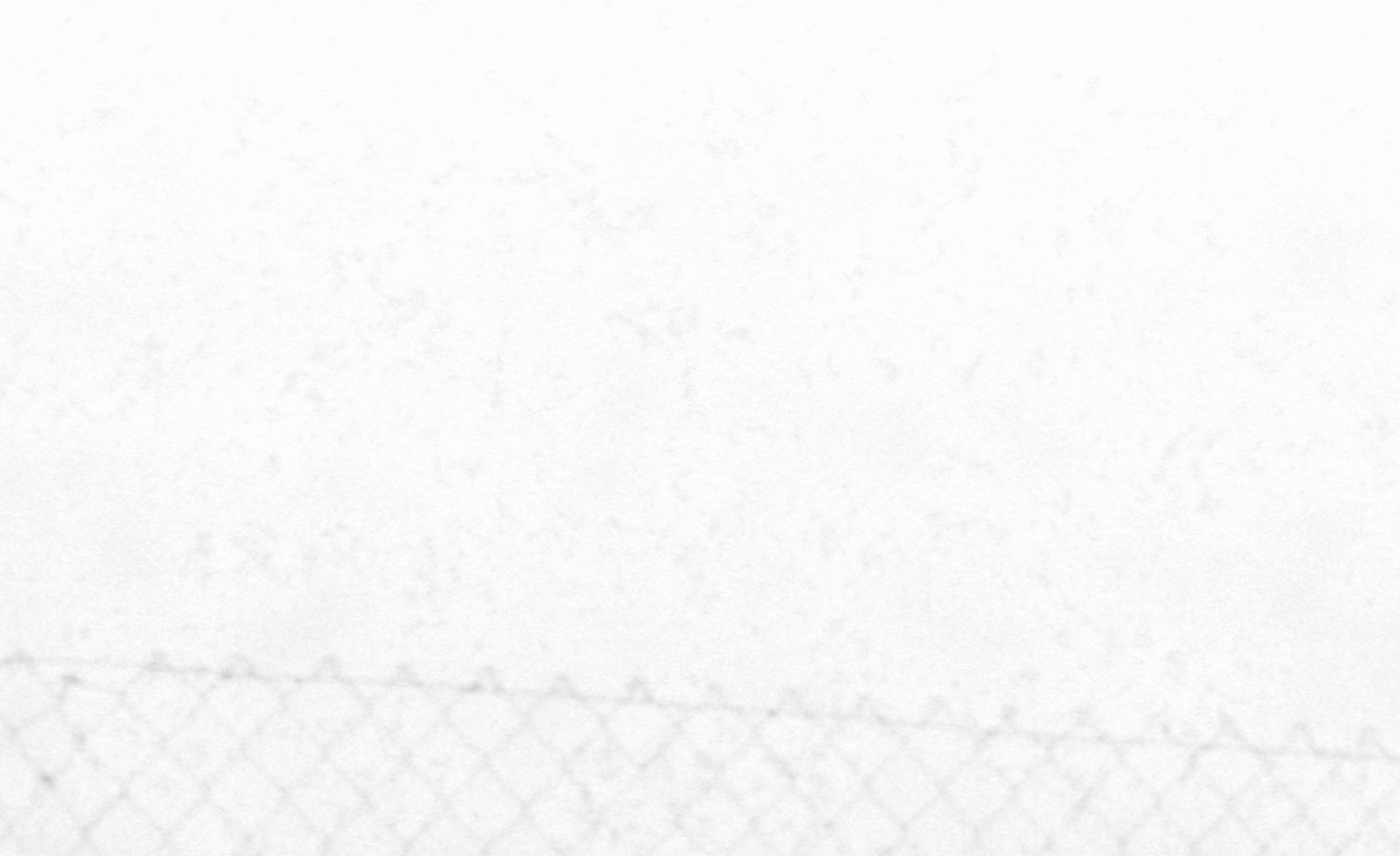

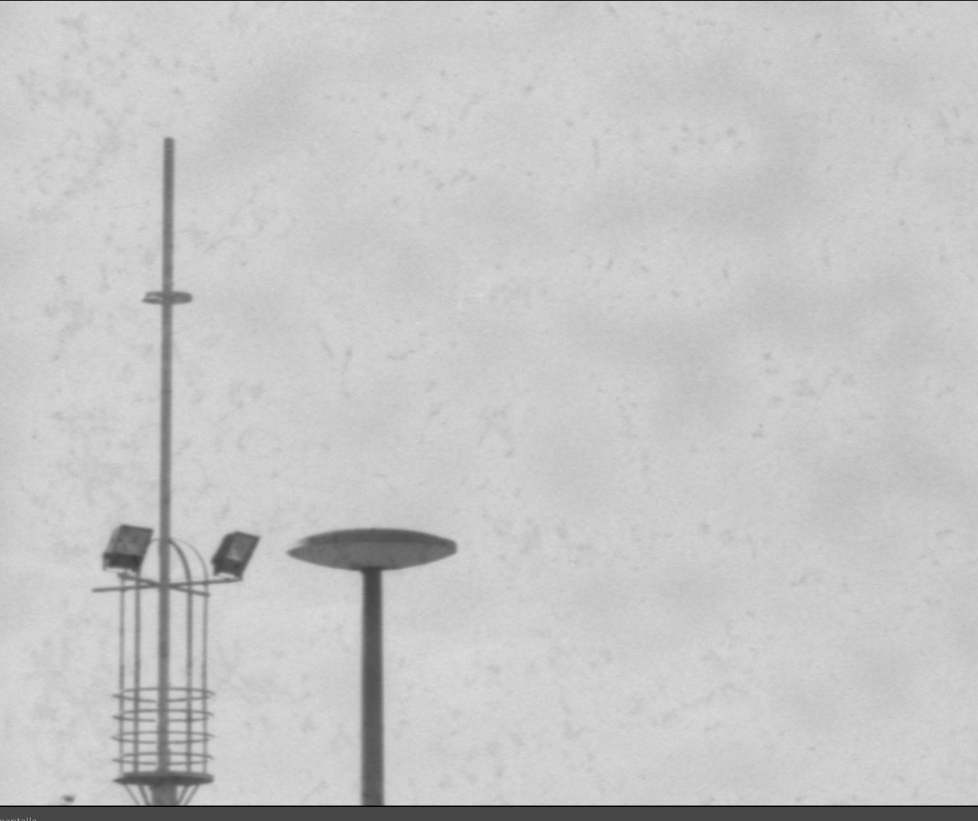

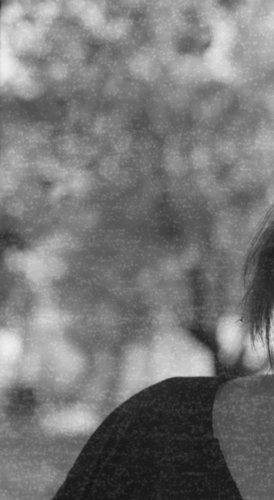

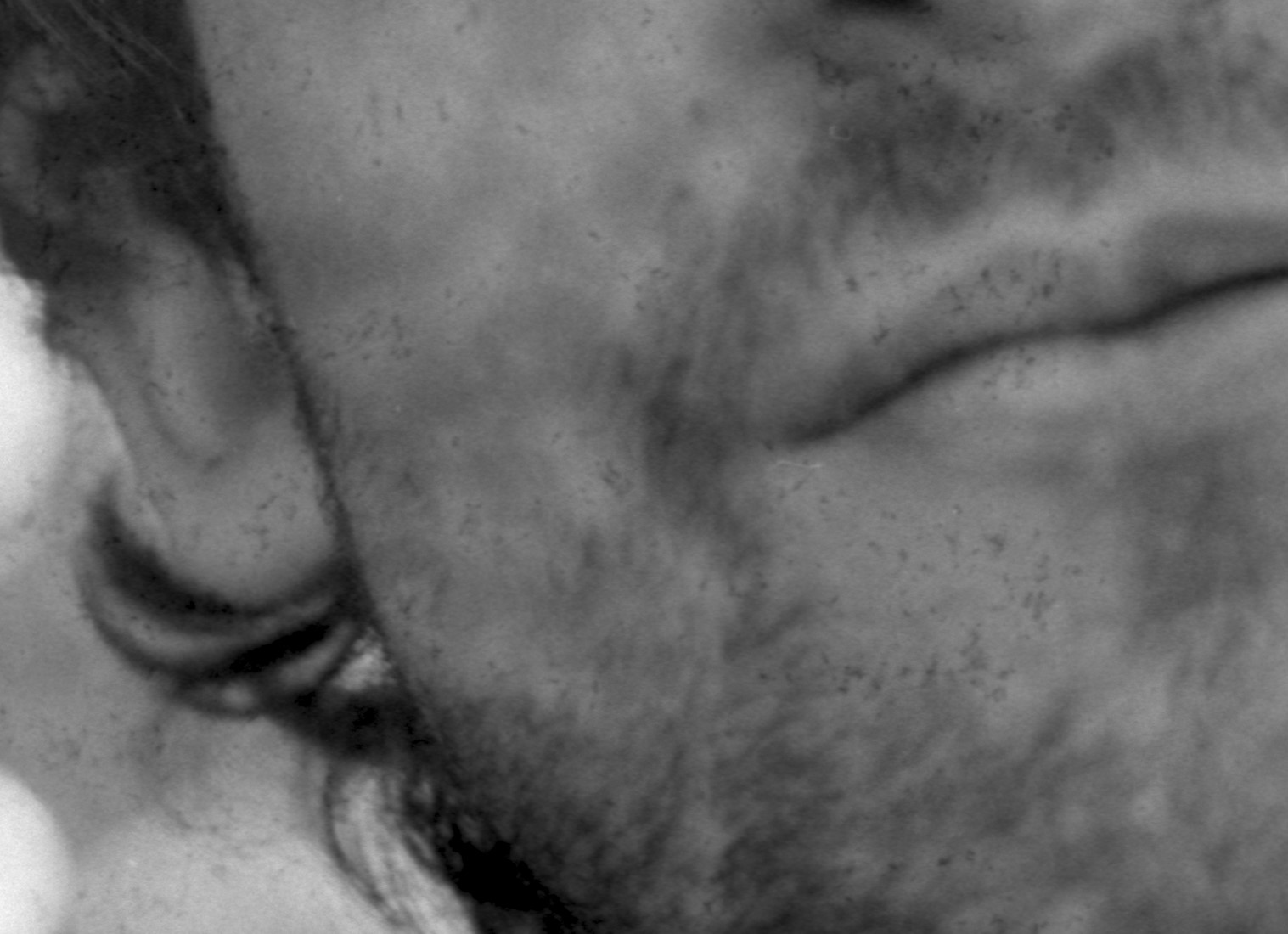

I had some troubles when developing my last two rolls of B&W Rollei RPX 100 120. Seems like small withe and black dots appear all over the negative (it is noticiable in the negative itself). I have included some pictures of it.
I developed it with a solution of 1+1 of Kodak D76 powder mixed 1 hour before developing. The fixer used is kodak T-Max that I have since January ( I use fresh solution each time).
What do you think it may be?
Thank you all!!

So on the negatives the white dots in your pictures are black and the black dots in your pictures are white? I ask that question so we do not have to argue about the colour of the dots on the negatives. Is this the first time you have used D76 at 1+1 or has this been the developer used with previous Rollei RPX 120 and without problems.
Answers to these questions may help to decide what is the problem

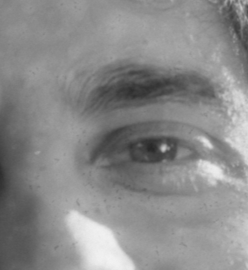

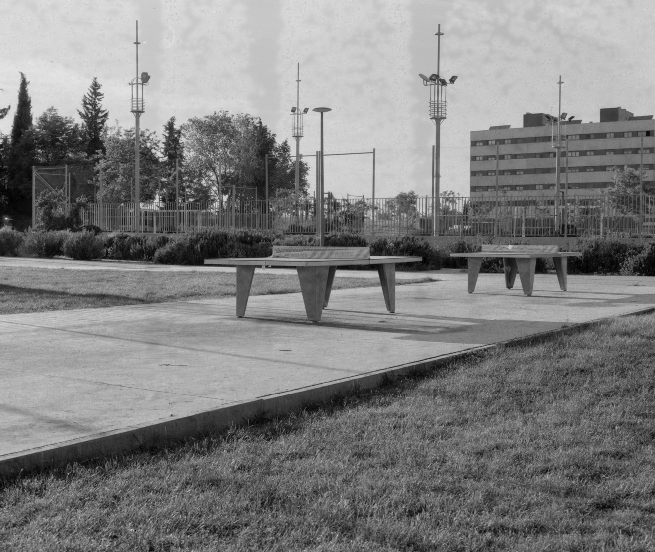

Hi @pentaxuser , thank you so much for your reply!
I have been using D76 for a while with 35mm but never before with 120. This specific solution has been used only twice, for 2 different rolls of 120, just after developing one I reused the quemicals for developing the next, however, spots are the same at both rolls, there is no difference.
The workflow I have used it has been the same as when I work with other 35mm stocks. It is true that I made the mix of developer just before the process but I would swear I mixed it well. May be the temperature? It might have been a bit warm by then.
Yes, spots appear the opposite color at the negatives. I attach the same picture positive,negative and portion.

Backing paper problem? This seems to have been going around lately; mottling on the film from the ink on the backing paper reacting with the emulsion. It seems to happen in humid conditions mostly.
Maybe someone with first-hand experience will chime in.
Doremus
There are two types of problems with backing paper that seem to be more prevalent recently - problems with the inked numbers and letters, and problems with mottling.
This looks like the latter problem.
The modern papers seem to be much more prone to the sort of humidity and heat based problems than in the past.
Oh!! Yes it seems that kind of issue. I have found a video in which it is explained pretty well, just in case someone else come here looking for answers to the same problem. I am going to mail back to the company where I purchased it to see what they have to say.
Thank you so much guys!!! I really appreciate it!

That is one manifestation of the problem, but I don't think it is the most common one.
Mmm ok,It is true that I did not let 24h in between and that could be the problem as well. Is there some way to determine what could be the exact problem here,in order to discard one (not fully mixed) or the other option? (Backing paper)

This looks like a backing paper problem and not related to the developing chemistry. The mottling pattern is a tell-tale sign, as is the recurring pattern shown in the image of the table tennis tables.

Having said that, the effect shown here does look somewhat like mottling caused by backing paper issues. It's usually caused by high humidity and sometimes by storing rollfilm in a fridge or freezer without it's original sealed packet....

So the effects produced by backing paper issues are the same as not fully mixing the chemicals, right?
No. Again, the possibility that this is a developer-related issue is very remote indeed and in my opinion rather random conjecture. Not to put anyone down, but it just doesn't fit these symptoms in any plausible way.
