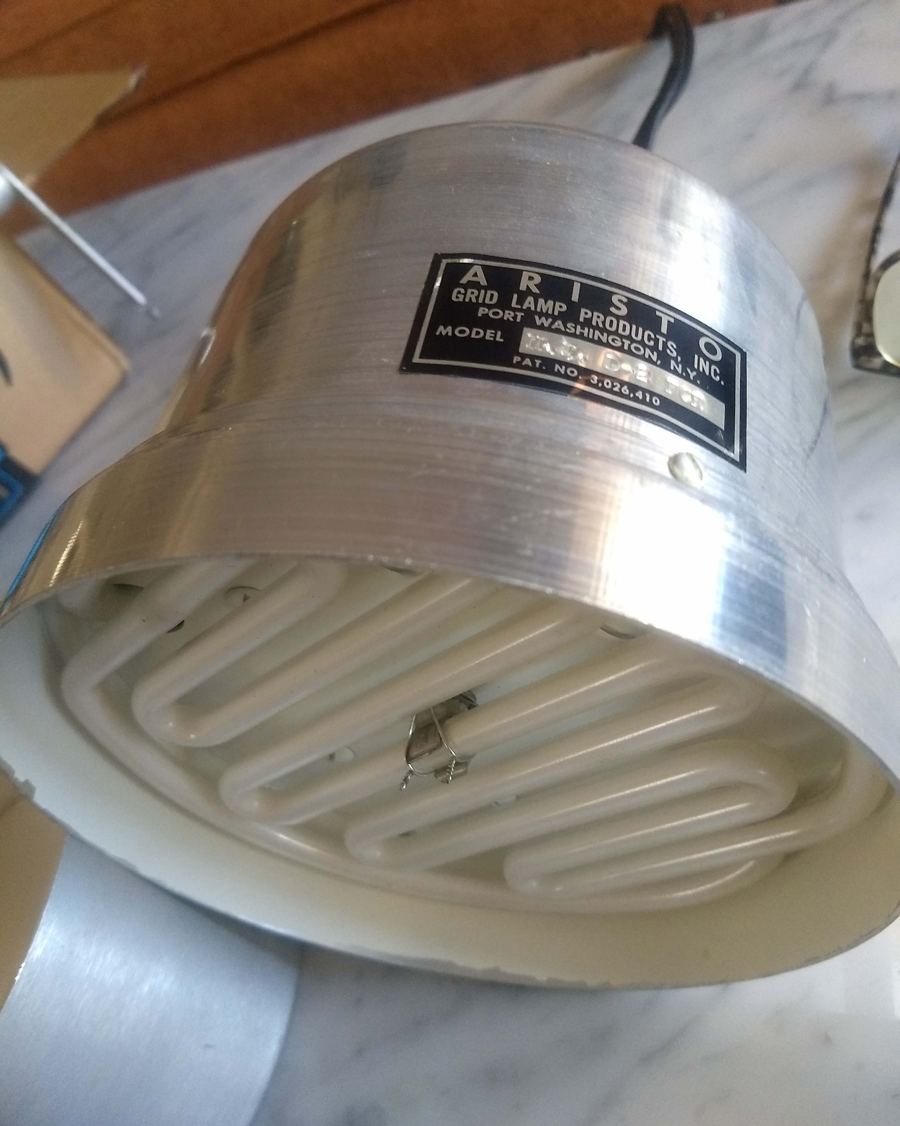

what is the difference between the "old school" cold light source diffusion head and the modern diffusion light source with those dichroic filters for adjusting the contrast of thelight source. Currently I'm happy using the condenser head and VC filters. Nothing wrong with touching up dust spots with a good brush on a final print. Reluctant to try the aristo cold light head for my D2V because my understanding is that they were meant for graded, not variable contrast filters. So I'm just at a quandary because when people mention diffusion light sources its generally the modern ones. Can anyone with knowledge suggest how to go about trying out my cold light source without setting myself up for disappointment? Tall order I know but I'm a patient man.
The older Aristo (and Zone VI) cold lightheads produced a bluish light which suited graded papers. Some people found that using VC filters with this head gave unsatisfactory results, but some people seemed to manage. Aristo more recently made a replacement tube with a wider spectrum which suited VC filters. Aristo was taken over but the new company still produced the new tubes on order. Search Photrio for Ken Nadvornick and Aristo. I don't know if the new company is still offering the tubes. It's rather old technology and companies move fast.

search internet using word omegalite or similar vintage fluorescent tube light your will find people have same question. other solution is do not use rose colored filter but develop all your film to be tailor-made for your light so it prints without the need of contrast filter on modern paper. aristo is volt arc now
Aristo grids are great if you can get the corresponding Zone VI cold light stabilizer. Without a stabilizer you will get unsatisfactory variations in exposure that will make you think you don’t know how to print.
There are different colors I don’t know which is better, but you need green and blue light for multigrade papers to work. So don’t be afraid of the teal color, it has the spectrum that works.

Thanks for all the suggestions. Still not sure what temperature this light may be. I have to do some research. Already spent a couple of hours trying to remember where I left it. But seems like it's best suited for 4x5 where I can control contrast of each negative. Unfortunately that enlarging lens has hazed so badly I hesitate to do any testing until it's replaced.
I guess I should figure out if this light actually works as intended first. Not looking forward to mounting it on the D2V.
Zone VI brought out a Compensating Timer to deal with the low output when using the Stabilizer. I posted over the years about this. If anyone is interested I can repost.
Interestingly, if the later wide spectrum tubes are like the tubes made for the VCL4500, they will be much less variable with temperature and maybe could be used successfully without Stabilizer or Compensating Timer.
@Heath Moore Your Aristo grid probably drops right into the ring. Unscrew the lamphouse from the condenser section and leave it like it has its head chopped.
There is a compensating metronome as well (so three vintage devices exist to help deal with light intensity fluctuation). You may need a sensor, might be easy to cobble together.
If you want a sensor, there's a post from me years ago with the part number for the sensor supplied by RH Designs . It's common and cheap at electronic suppliers.
