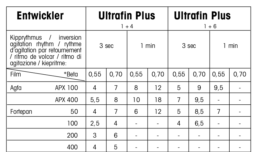

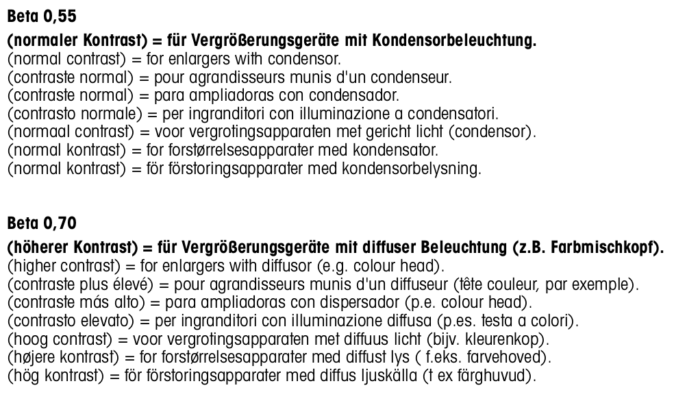

Tetenal developers guide, PDF;
And then they give two times, for the desired contrast level, on every film:
