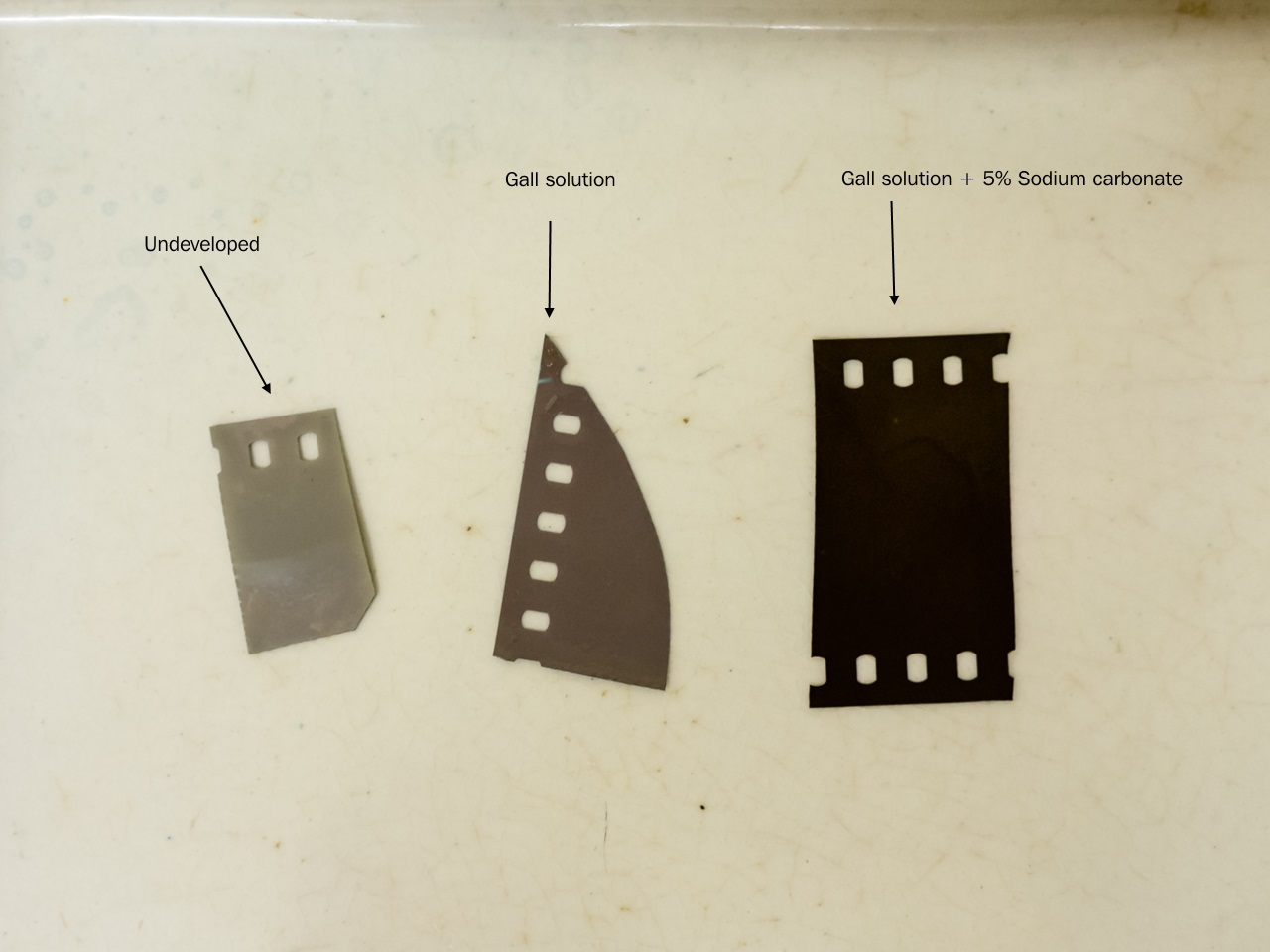

This probably sits halfway between alt process and b&w chemistry really ... thought it might be of interest, perhaps even might trigger some technical speculation by the Chymists.
Anyway ... I have been experimenting with making Iron Gall Ink for a friend. The first step is to crush some oak galls and set them to ferment in rainwater in a jar for a couple of months.
(The theory seems to be - if I am paraphrasing accurately - that the combination of hydrolysis and enzyme action from fermentation will turn some or much of the Tannic acids and Gallotannic acids in the galls to Gallic acid; the subsequent step is to add Ferrous sulfate to the mixture, which reacts with the gallic acid present to form a pigment, which is the basis of the ink. IG ink is extremely robust once on paper, and does not fade)
Now, from my (dangerously superficial) understanding of photochemistry I know that Gallic acid can be used as a toner for cyanotypes and other alt-processes, and that it is a precursor for the production of Pyrogallic acid, which (as any skoolboy kno) is a developing agent for Silver halides.
SO, thought I, let's dunk a bit of exposed 35mm leader in some of this fermenting goo for an hour, just to see what happens. Results in attachment.
Clearly something's gone on ... but of course we know that all sorts of macerated plant materials with a bit of alkali added will develop film, so there's no conclusion as to what the developing agent is here.

You have rediscovered gallic acid, an ester of pyrogallol. :smile: The extract may stain emulsions.

The Calotype developer is a physical developer, ie the silver comes from the solution.
To develop modern film a chemical developer using gallic acid with alkali accelerator would appear to work as your example shows.
Gallic acid works faster in combination with phenidone derivatives ,with which it is superadditive, as in this patent:
http://www.google.com/patents/US2685516

Two interesting links Alan, thank you.
NedL
Aug 23, 2012
3,421
Sonoma County, California
I've been confused about what "physical development" means. In historical accounts of the calotype process, it seems common to try development with gallic acid first, watch how quickly the image comes up, and then add acetonitrate of silver to speed it up and increase density if necessary. Also I've seen mentioned the idea that you can balance the AgNO3 and acetic acid, the AgNO3 to increase development and the acid to restrain it.... giving great control over development. Some Authors implying that this is where the real control over the negative is. ( In this way, it's similar to how people talk about modern film development. )
So I guess if I develop a calotype only using gallic acid, it is "chemical" development and if I add a little AgNO3 it is "physical"? Is this related in any way to lith printing? Is the "infectious development" in lith printing a kind of "physical development"?
I find calotypes difficult and time consuming enough that I probably will stick with purchased gallic acid, but it would be interesting to see if a calotype could be developed in the gall oak solution, with no other additives. In water, gallic acid is a saturated solution at something like 0.8%, I suspect if you let enough evaporation occur in the fermented gall oak solution, it might get close to this?

I apologize, my intent was to point out that oak galls contain gallic acid and its esters and it can be a natural source for a developer. Many people would be unaware of this had you not posted.
there are much better authorities than me to answer your question, so I'll quote one:
"In [physical development] the silver ions for reduction at the latent image specks are originally supplied from the developer solution"
(LFA Mason, Photographic Processing Chemistry 2nd Ed. p14)
As I understand it, "Infectious development" is a catalytic reaction triggered by the oxidation products of hydroquinone during development, so is not related to physical development (my source is Mason again
But we'll need a Gerald or a PE or indeed an Alan to confirm or correct this.
