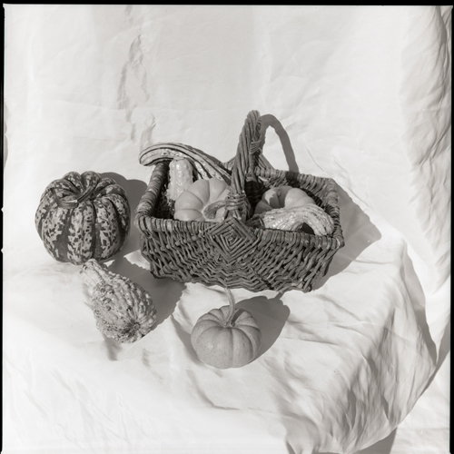

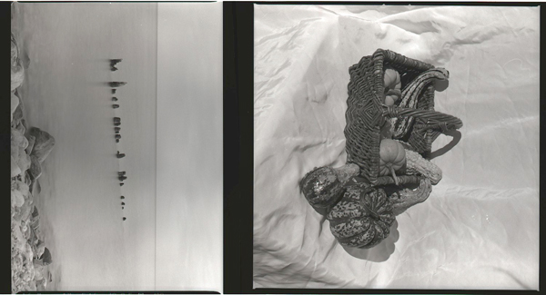

Alright, here's a scan of old and new, head to head (scanned together). I'm not sure if it's solved, but it's better, I think. Also another frame from the new roll (not the same as the other frame). Since I did the new ones outside (to have enough even light), the wind was blowing the edges of the cloth, too. I didn't have any white foam core so the next roll (in the P 645) will use some.

Bethe, I re-sized and rotated the Hasselblad neg to the same size and orientation as the 645 and other hasselblad neg, put them alongside each other to have a look.
It's a bit hard to judge, but it does look as though there is uneven illumination or development in the 6x6 negs, but it could be a lighting situation only.
Your original shot was in low contrast lighting (at least it looks like it is). Processing problems, or even or uneven illumination from the lens onto the film, will be easier to see if the contrast or reflection, off the object, is even.
If you could run your next test with a fairly flat subject in a fairly flat lighting environment, I believe you will be able to see with greater clarity, any processing or lens coverage problems, if you have any that is.
I'm not much of a processing expert, but over the years I have found longer development times will ensure consistent and even development, with the caveat being that one does reasonable agitation.
