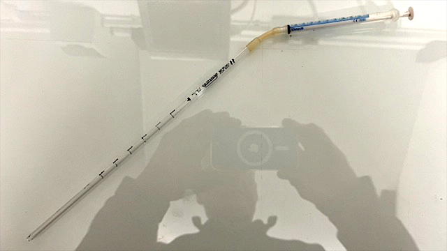

You should be absolutely fine at 18°C and your washing method should be fine. I use purified water and a bit of Kodak Photoflo, if you are using a wetting agent you need enough to change the surface tension of the final rinse.
Matt King has a recipe for diluting Photoflo with alcohol that makes it easier to measure and handle in small doses.
That's clever, but there is another way. This is what I use, a 1ml plastic disposable syringe attached to a 1ml plastic disposable pipette via surgical tubing. Anyone in the medical/veterinary profession should be able to provide these items. Apologies for the rubbish picture.
