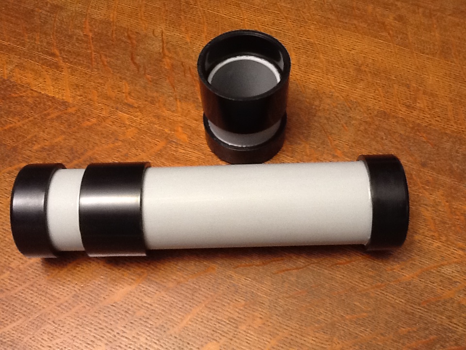

I'm with Ken on this one. Started using BTZS tubes for 4x5, and I can easily develop 6 sheets at a time. Went up to 5x7 and decided to make my own tubes from plumbing supplies available at the hardware store. Now that I'm shooting 8x10, I've done the same thing and so far it works great. Never had any problems with uneven development, uses small amounts of developer and developing step can be done in normal room light. After development, I turn off the room lights, leave one safelight on, open the tube and dunk it in a tray of stop bath for about 30 sec. Then I extract the film and place in in a tray of fixer. After about 15 sec, it's safe to turn the room light back on for the rest of the fix time. View Camera Store has some videos that explain the process.
Here's the 5x7 tubes I made:

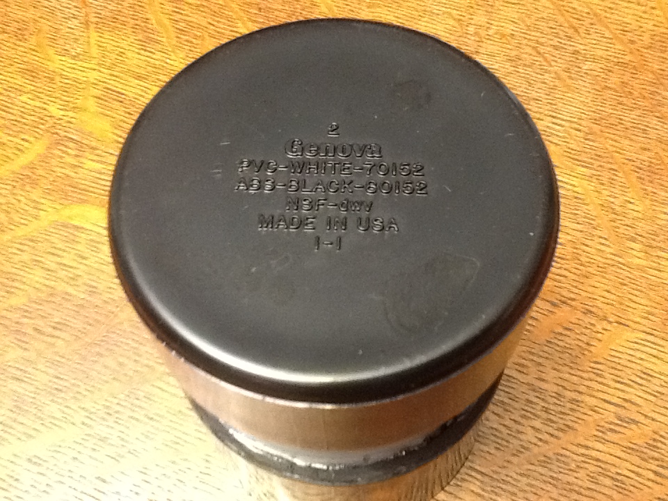

jimjim, is that white end cap light 100% light? My understanding is that they aren’t. Or is it grey pvc? I can’t tell for sure from the photo.

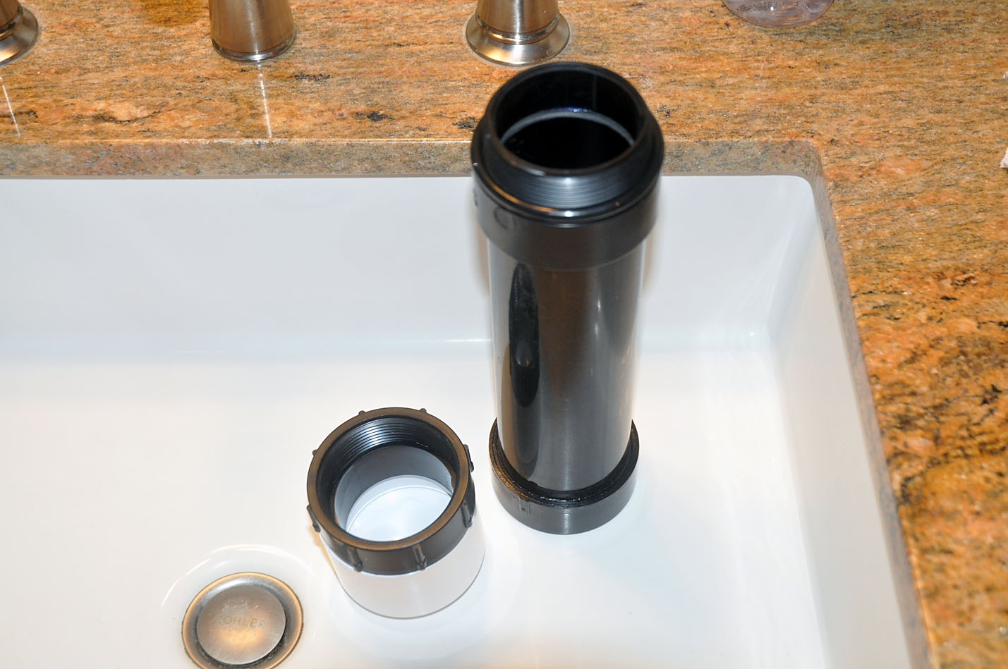

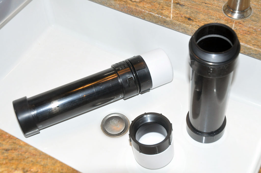

I also use homemade 5x7 BTSZ tube for 5x7. I was able to find black abs end caps and used grey pvc electrical conduit because that’s what I had.
