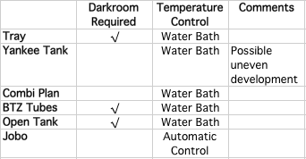

I favor the Jobo tanks with rotation development for the following benefits:
1. daylight processing
2. minimum chemical usage
3. very even and consistent development
This is what I ended up using plus I have temperature control for color work.
See attached for the trades as I see them.
Steve
