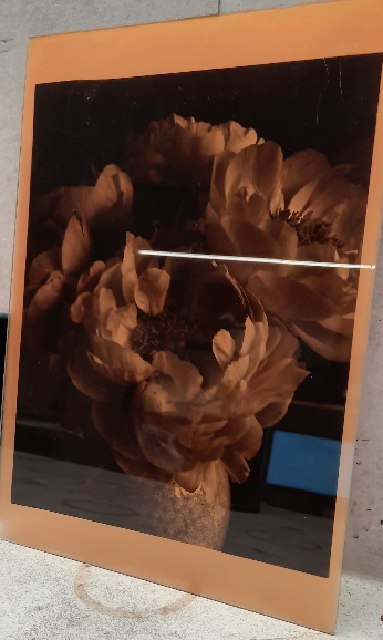

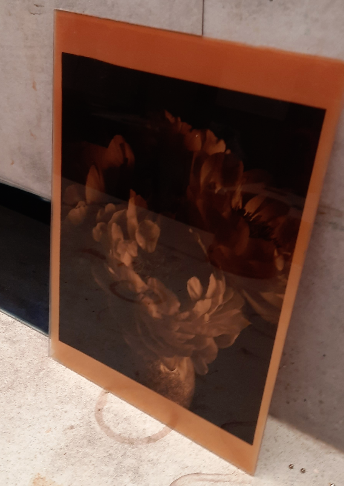

I honestly don't think it would matter all that much, but if this is going to be a black/dark silver image on top of a gold background, you'd want something that yields sufficient density. I'm thinking along the lines of Dektol or ID62; something fairly clean-working that will build lots of density. Btw, I've done pretty effective (albeit somewhat 'blingy') 'orotones' by transferring carbon prints onto glass and then backing the glass with a mica faux-gold pigment.
This is a test print made as outlined above. Not exactly what you're looking for since it's not a silver image, but black pigment in gelatin. The end result looks similar though.
View attachment 418755View attachment 418757

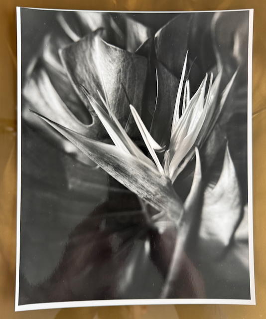

I was experimenting with a new petzval lens that came in the mail shot on 4x5 Ilford Delta 100 developed with F76+. I made a couple of traditional prints of a bird of paradise taken with it on Ilford Multigrade glossy that I think developed well and had a satisfactory amount of contrast for my taste.

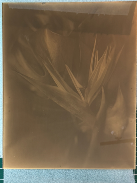

Seeing the results, I decided to develop the image on a couple 11x14 dry plates that I have had stored in the dark for around 2 years. I made 4 test images on 6th plates at the distance I'd be projecting for my 11x14 on and the final image developed fine in a pyro solution of 200+1 and has contrast. The final prints however lack a bit of that contrast that the test 6th plates have. Having typed this out I am wondering if my plates had lost a bit of sensitivity having been stored for so long?
Even though the prints didn't quite work out it did remind me that I have had the question in my mind for sometime of if there is a developer that I could use that would give the brown tone of pyro but get a little more contrasty pop without introducing too much black into the final print.
