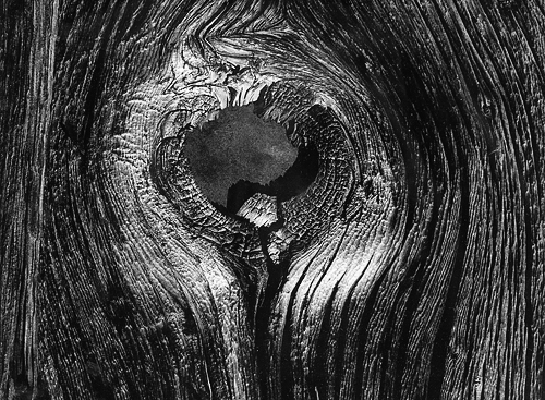

I've used Rodinal and Pan F, 9 mins at 1 to 50, for years and got terrific results and agree with all the other comments here about this combination. See attached example.
