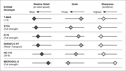

Is there hidden somewhere deep inside the guts of APUG a matrix or table of different developers and what they do. Not The Massive Dev Chart with times and such but what the differences are. What happens if I use Xtol instead of D-76? What can I expect from Pyro? I'm missing a simple matrix or table with info about pros and cons with various developers.

Pyrocat HD seems to fit all those criteria extremely well, and so does Rodinal. varying the concentration to cope with extremes of contrast. Rodinal was a "Universal developer" Agfa recommended it for papers as well at one time.
Ian
