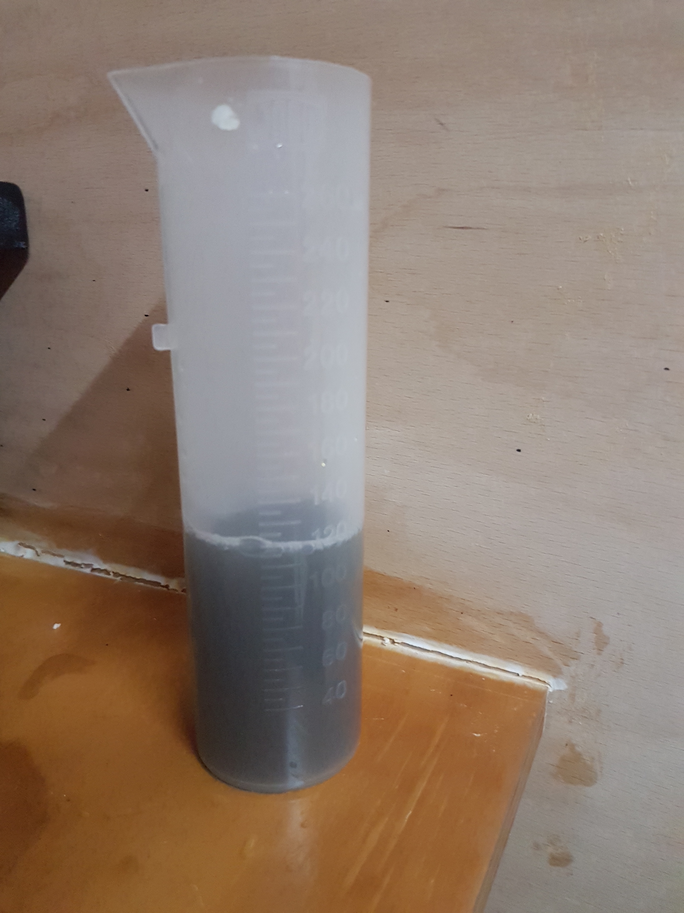

Hi, I've been trying to print some images and iv been having issues with the developer.
I'm able to do one or two test strip fine but when I come to the next one the developer turns gray and has an unusual smell strange. also, the image turns gray.
Iv tried washing the jobo tank and still get the same issue any ideas whats going on?

It's freshly mixed, Ilford multigrade developer, yes it is being reused the developer from the test strip. It's a new bottle of dev and a new box of paper the only place I could think of that could be contaminating it is the jobo tank which I have dismantled and thoroughly cleaned out but i am still getting the same result.

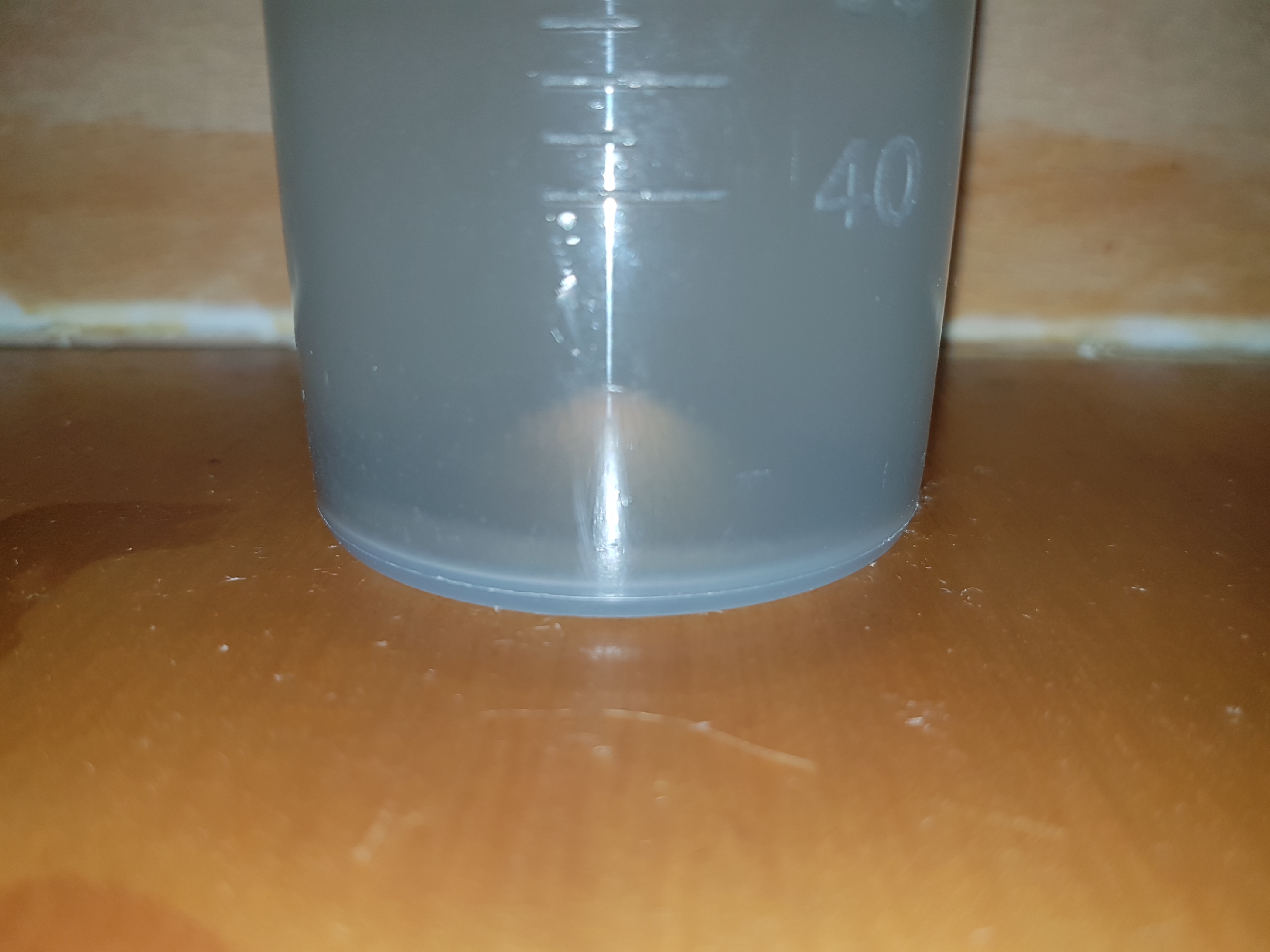

There has been an update with the dev when I went back to it, it had somewhat cleared and there was a powdery residue at the bottom I tryed to get a good pic but this was the best that i could get

I think what you are seeing is neutralization of the developer by fix entrained/left in the processor. The strange smell you mention could be ammonia (from "rapid fix"), and the pile of precipitate shown in your last post could be sulfur, or one of many complexes formed during the fixing process. I would strongly suggest (1) rinse the processor very well between prints, or (2) use trays.
Edit: What baffles me is why the blue/black color of the solution.
