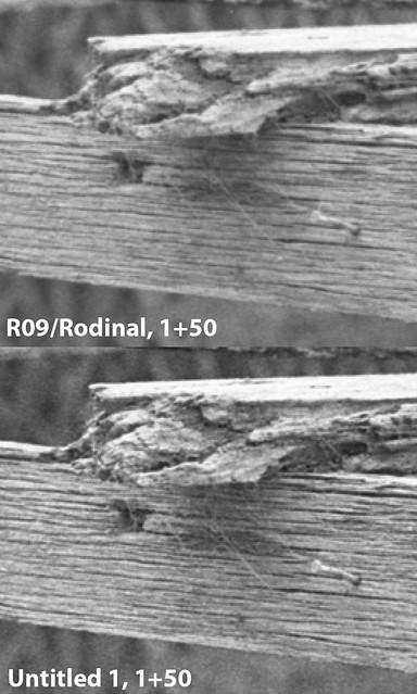

Rodinal difference vs custom developer on HP5+
The custom developer produced lower negative constrast (you would use higher grade in printing etc), but higher local contrast.
U1_v_Rodinal by athiril, on Flickr

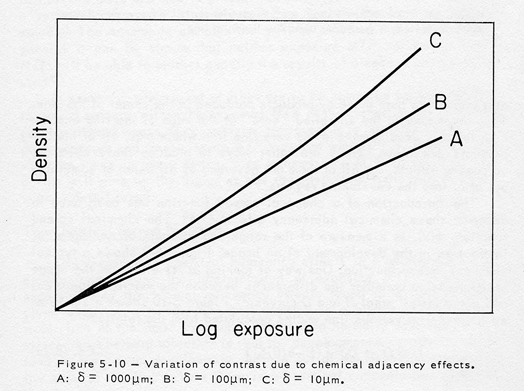

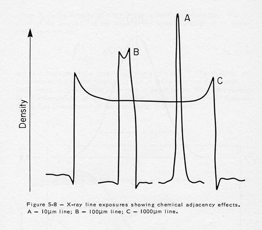

Here are examples of a fine line simulation with one developer considering a line in 4x5, 120 and 35mm formats. It is from the work of Kriss.
You will note that in this film/developer combination, as the line gets finer, the contrast goes up.
PE
PE
Interesting the graph behaves just like the Dirac Delta function. As the interval along the x-axis (the line width) becomes smaller the apex of the distribution (density) becomes higher.

Photo Engineer
Apr 19, 2005
29,018
Rochester, NY
Micro and macro contrast are terms widely used in the industry and are illustrated in my earlier post. I think changing the terms arbitrarily or misunderstanding them would only confuse people.
PE

Photo Engineer
Apr 19, 2005
29,018
Rochester, NY
Peter;
In the example I posted, the edge effects control apparent sharpness. Due to the nature of emulsions and developers which can interact, edge effects can either cause lower or higher contrast as the size of an object decreases. As size decreases, one goes from the realm of macro contrast to micro contrast. Thus, you might take a picture of an object on 4x5 film and 35mm fim and make the image the same size in a print and have them appear different in contrast because the smaller image may have higher micro contrast.
PE
