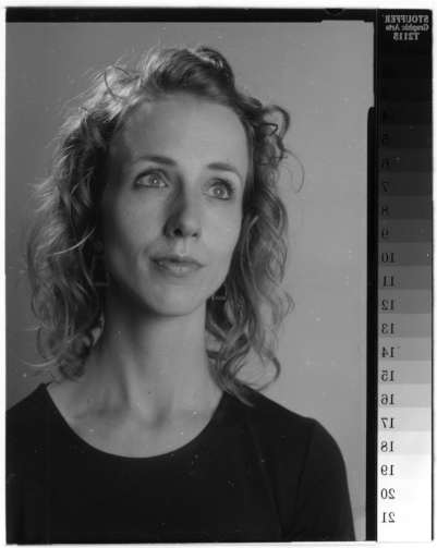

I'm doing carbon printing and it turns out that using DAS as a sensitizer pretty much forces me to use extremely long tonal-scale negatives. It's a long story; if you're curious, here's the background to it: https://tinker.koraks.nl/photograph...of-das-carbon-with-continuous-tone-negatives/
To quantify (sort of, approximately):
The tonal range of this negative is around 1.95logD. This is about the lower limit of the kind of density range I need. A little punchier than this negative would be nice. I guess 2.10 or 2.25 from a 'normal contrast scene' (sorry; vague) would be right on the money.
I did this (on Fomapan 200) by exposing at 125 and overdeveloping by roughly 100% in Instant MyTol. In fact, I think for this negative I just heated the developer to 40-ish degrees (C) and developed for 6 minutes or so.

Btw, this is an example just for the heck of it of trying to rescue a negative for the purpose of carbon printing with a low contrast tissue:
4x5" carbon print from part of an 8x10" negative to the left. This negative at this stage would probably have printed OK-ish on grade 0, I guesstimate. Insufficient for this particular carbon tissue formulation, so I gave it a round of chromium intensifier (nasty, but it does the job well). The print on the right is from the same negative, same carbon tissue, same exposure etc. There's some gain in b+f but it's still manageable.
The original negative was developed for 6 minutes in Instant MyTol with a small teaspoon of sodium hydroxide pellets and a pinch of potassium bromide added to it. Temperature was probably 25-ish C. Development after the chromium intensifier bath and thorough washing was with ID62 for a minute or so.
