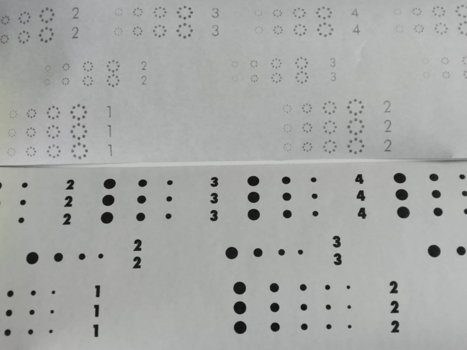

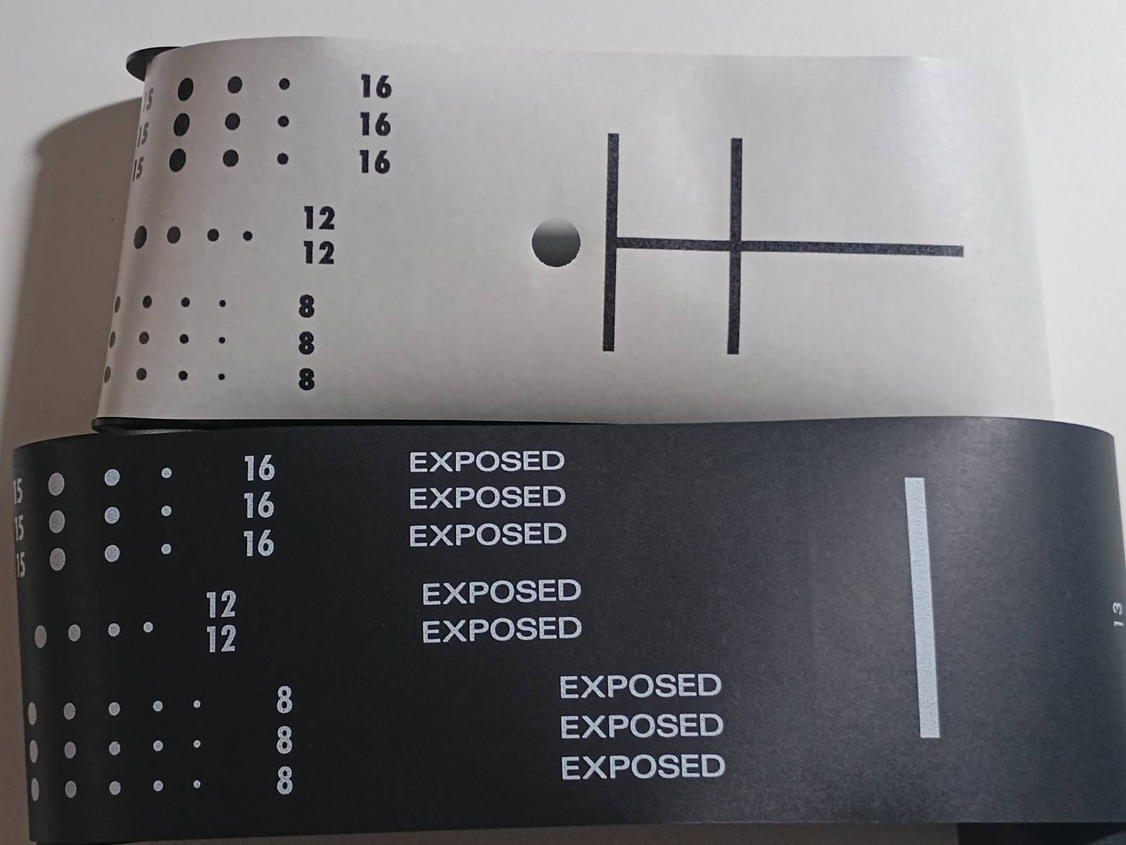

Adox CHS-100 II is a good choice for old folders with red window. The frame numbers are pretty good visible in the red window.
Top: Foma
Bottom: Adox
Top: Harman (Ilford, Kentmere)
Bottom: Foma

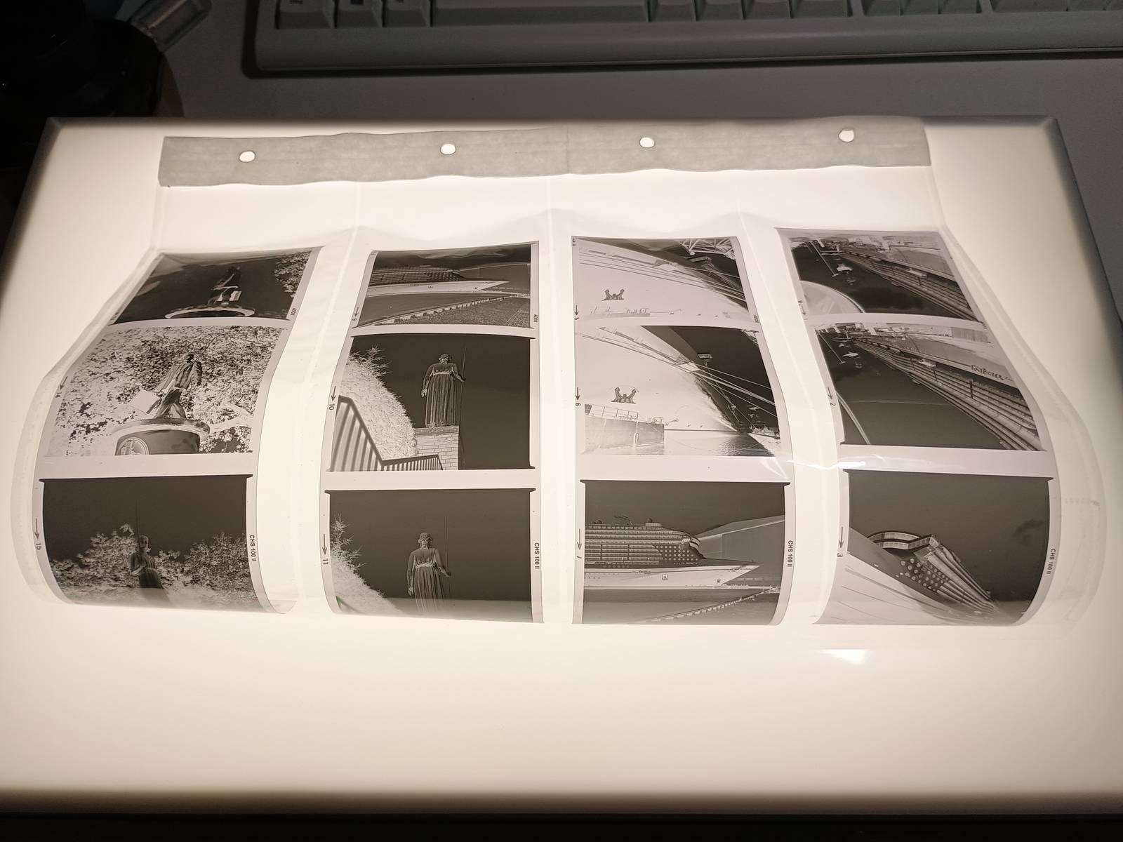

But I dislike the curl of the Adox films.
Top: Foma
Bottom: Adox
Bottom: Foma
I've gone back to shooting Kodak Tmax 100 and TMY 400 in 120 since the price is pretty much back down to earth for a while. One really gets spoiled with those two films with the way they dry. Almost as flat as a pancake! They are almost impossible to use in old folders with fairly dark or scratched ruby windows. Kodak backing paper has the lightest numbers of any backing paper I've seen. I can use it, but carry a small penlight and reading glasses to advance frames. CHS 100 is just the opposite of Kodak in both the curl and print numbers. Can't have everything I guess.
