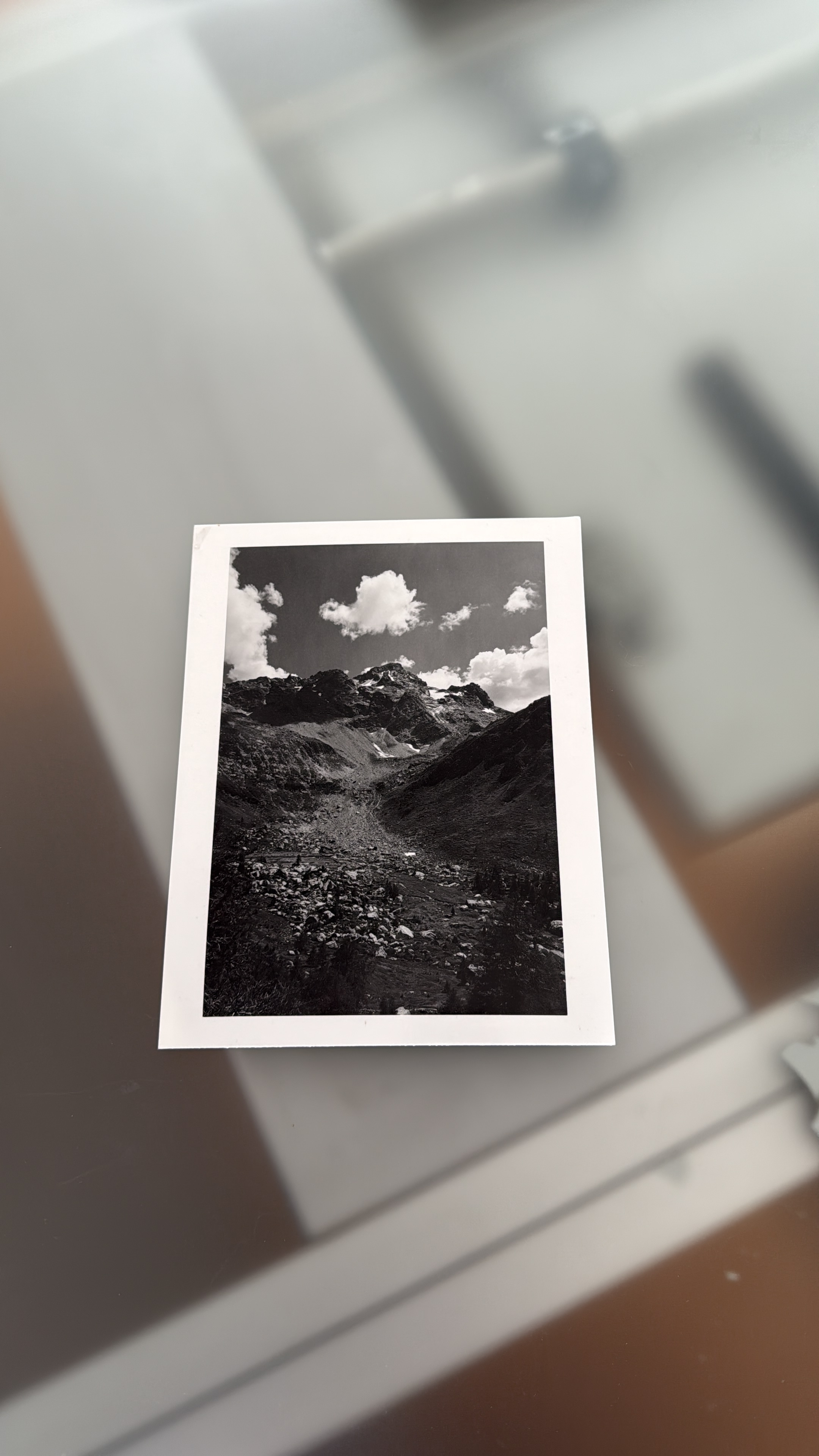

For 4x5 - I love the Adox CHS 100 II in 510 Pyro, 1+300, 21°C, 2h stand development - came out perfect.
Pic. is from print with filter 3.
