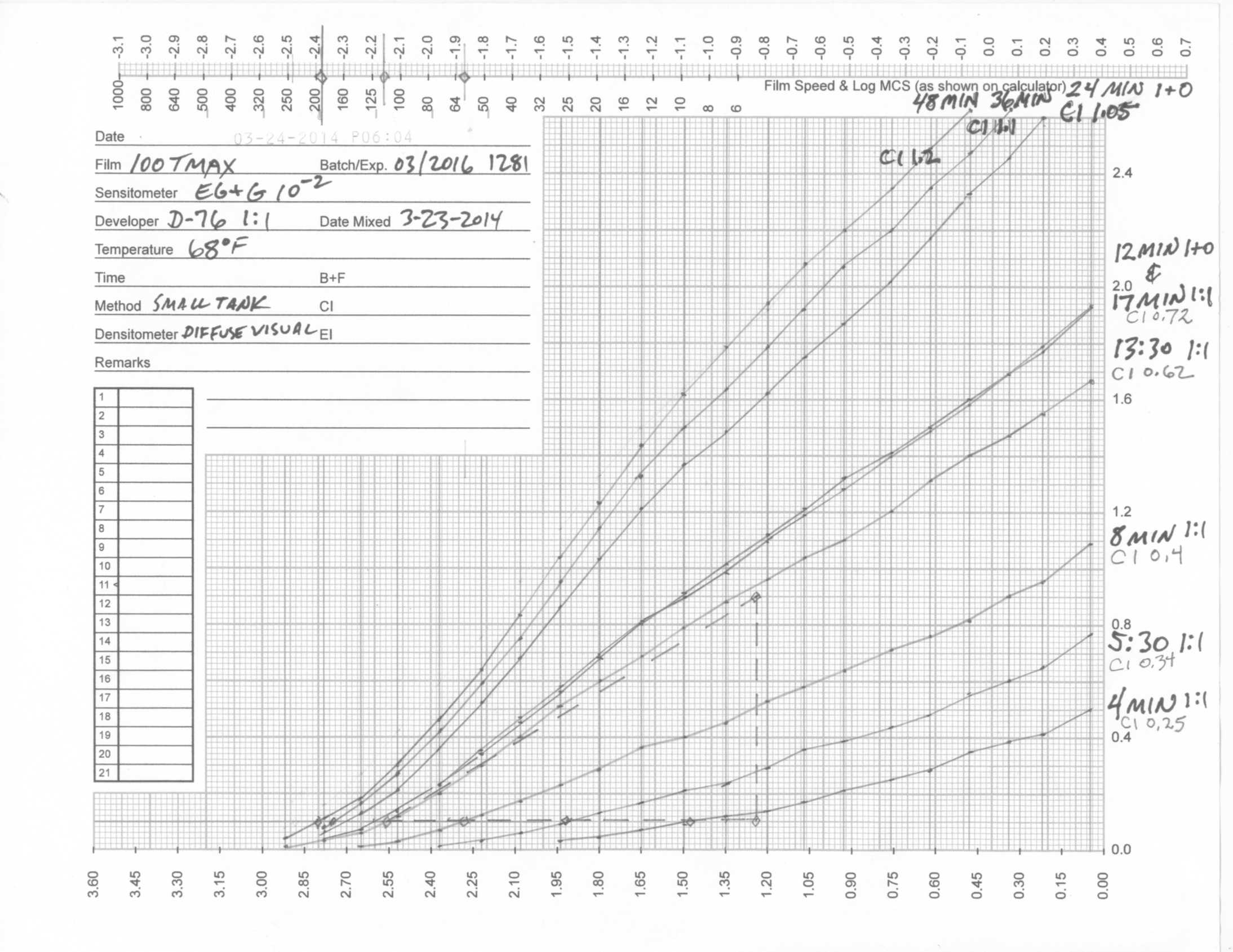

My guess is that the mid-tone areas would mostly be similar. My concern is mostly on the highlight and shadow areas, especially the highlights. My thinking is that a less rapid development in the HL area with a more diluted developer over a longer time will produce more details than a more rapid development with a more concentrated developer over a shorter time. What do you think, or have you experienced?
(I know I can, of course, do a bunch of tests myself, but I don't have the budget and time — not to mention that I don't have a densitometer.)
In general, I'd expect prolonged development with high dilution (especially if agitation is limited) to reduce contrast in the highlights, but also to reduce overall highlight density -- that is, it would act as a compression for values above Zone IV or so. This is because there's more exposed halide to develop in those areas, so local exhaustion of the developer comes into play. This doesn't occur in the shadow areas, however, because there's less exposed halide there; the result can be an expansion of shadows (even a true speed gain), combined with compression of highlights; effectively introducing some shouldering in the H+D curve.
