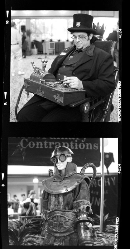

Delta 3200 is a great film. I've posted these before but here are some shots on Delta 3200, Yashicamat 123, EI 3200 developed in T-Max developer.
A couple of shots from Anachrocon here in Atlanta last year:
