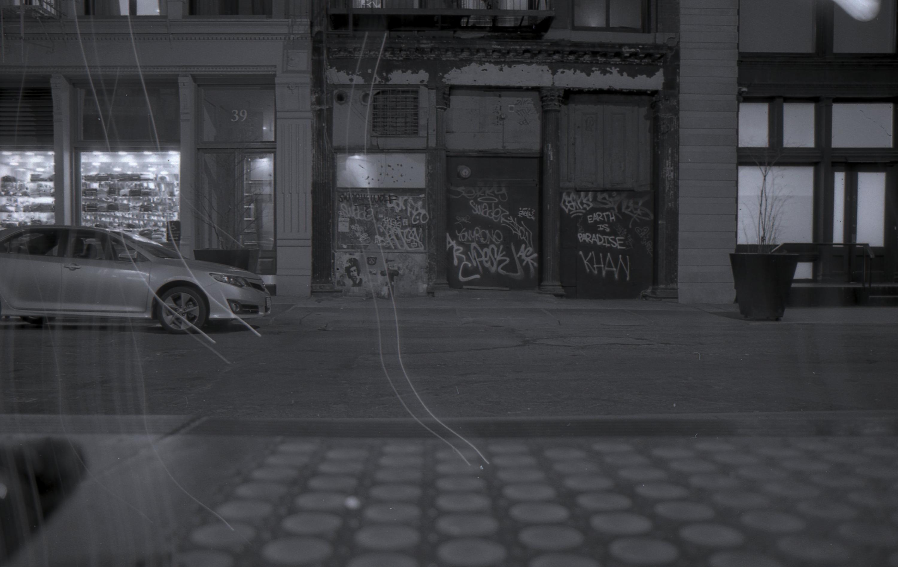

I clipped the corners
I'm not sure if I cut enough leader off (I clipped the tongue, then clipped the corners)
The reels were brand new, straight out of the box
Still not sure why it bound it

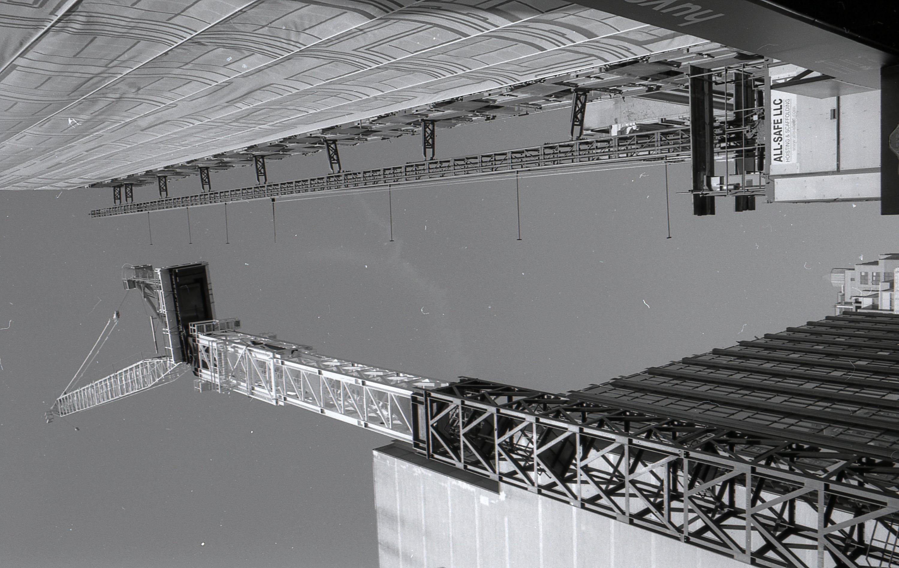

Some smudge/smear in the center?
Can't figure out what happened here on the left
