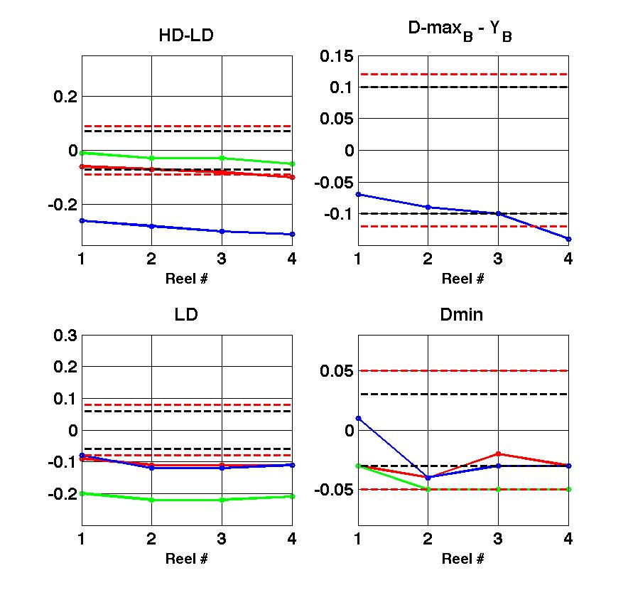

I ask this cause I am frustrated with continuing to have low HD values with blue being lowest in the HD-LD values-aims. I measured the temperature today of the chemicals being loaded into the tube of the Sidekick and discovered that (1) the pre-wash is heated to ABOVE 100°F presumably to help heat the reels and film and that (2) I had to raise the temperature that the developer was heated to in the tank because somehow once it got pumped into the drum it lost a couple of degrees. So now I read it at 100°F when it is in the drum. I processed fresh control strips (shipped overnight from Liberty Photo) after increasing the developer temperature a couple of degrees but STILL my values are basically unchanged. (See figure) My major options are to either (1) further increase temperature, (2) extend time.. seems I would need to extend by 15% or so, or (3) try again with freshly mixed developer, but this developer was mixed two days ago.

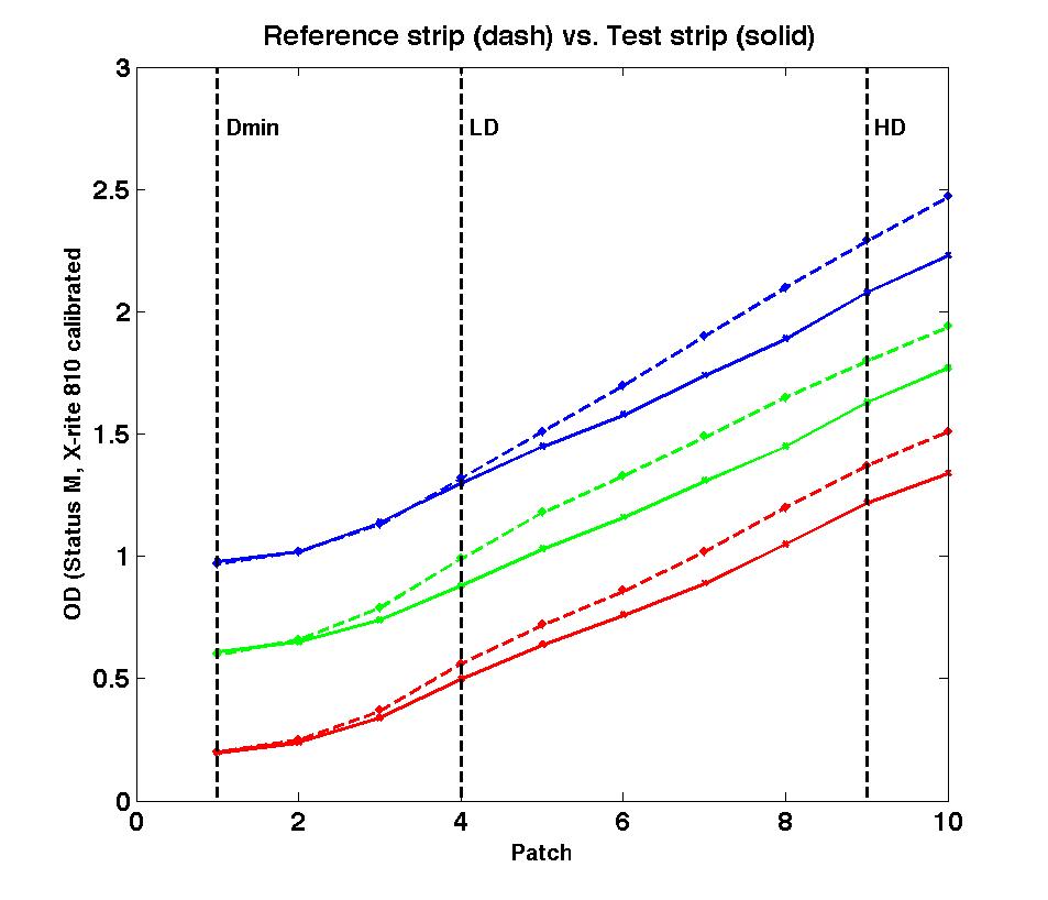

Here is a plot of the density of the patches of the reference strip vs. one of my test strips. This test strip was actually before I adjusted the temperature upward (I thought!) although I didn't see much improvement in the HD-LD and LD values, and hence why I am asking if my real problem is that a pre-wet means I need to EXTEND my DEVELOPMENT TIME.
Unfortunately, I haven't been able to locate any data on what the exposure value of each patch of the test strip is so I have simply numbered the patches. I have omitted the Dmax patch as it is definitely a jump up in density, so that step is not uniform (I am assuming). You can see that the overall problem is a lack of development, so I think extending time might be the biggest help at this point.

stefan4u
Aug 27, 2006
167
Dear Justin.
Actually your last plot looks very good, the curves seems to be MORE parallel than the curves from the reverence strip. If using Flexicolor I had mostly times of 3:25 min, somewhere in the processing manual is written that times can be adapted within certain ranges to maintain an optimal result for rotary procesing. You don’t have to stick at 3:15, a drum development is simply different from a continuous industrial development machine.
Does your sidekick do a wash step after development? If so, skip that and go directly to the bleach step, or preferable to a stop bath prior bleaching.
And this may be the most important part; a prewash is originally not intended in C41, this will lead to (slightly) different densitometer readings than with films processed without prewash. This you can read somewhere in the process manual. The trick is that you normally do not see the difference in the print, and a proper tempering in home processing is quite a struggle without prewash. So it’s a bit up to you weather you want chase behind process results of a different development machinery (continuous cine type machines or minilabs) or accept minor differences and try a print first, to get an overview of the “visible quality” of your Process. Again, your curves look more parallel than the reference…
Regards, Stefan

Stefan,
Thanks very much for your kind encouragement. You are right and you motivated me to go back and read through the section on rotary processing in Z131 (section 3). I had read through it back when I bought my Jobo but I never had a densitometer or control strip then. Once I got those I read through section 5 on using the control strips, but everything in there is quite focused on replenished continuous systems, in terms of advice. You are right that it says in fact for rotary procesors:
If the control-strip density values plot within the processcontrol limits for LD and HD – LD, you do not need to adjust the developer time. If the LD and HD – LD parameters plot significantly low (out of control limits), then increase the developer time slightly on each subsequent process run until the control-strip plots are in control. Usually an adjusted developer time that produces good control-strip densities falls somewhere between 3:15 and 3:45.
