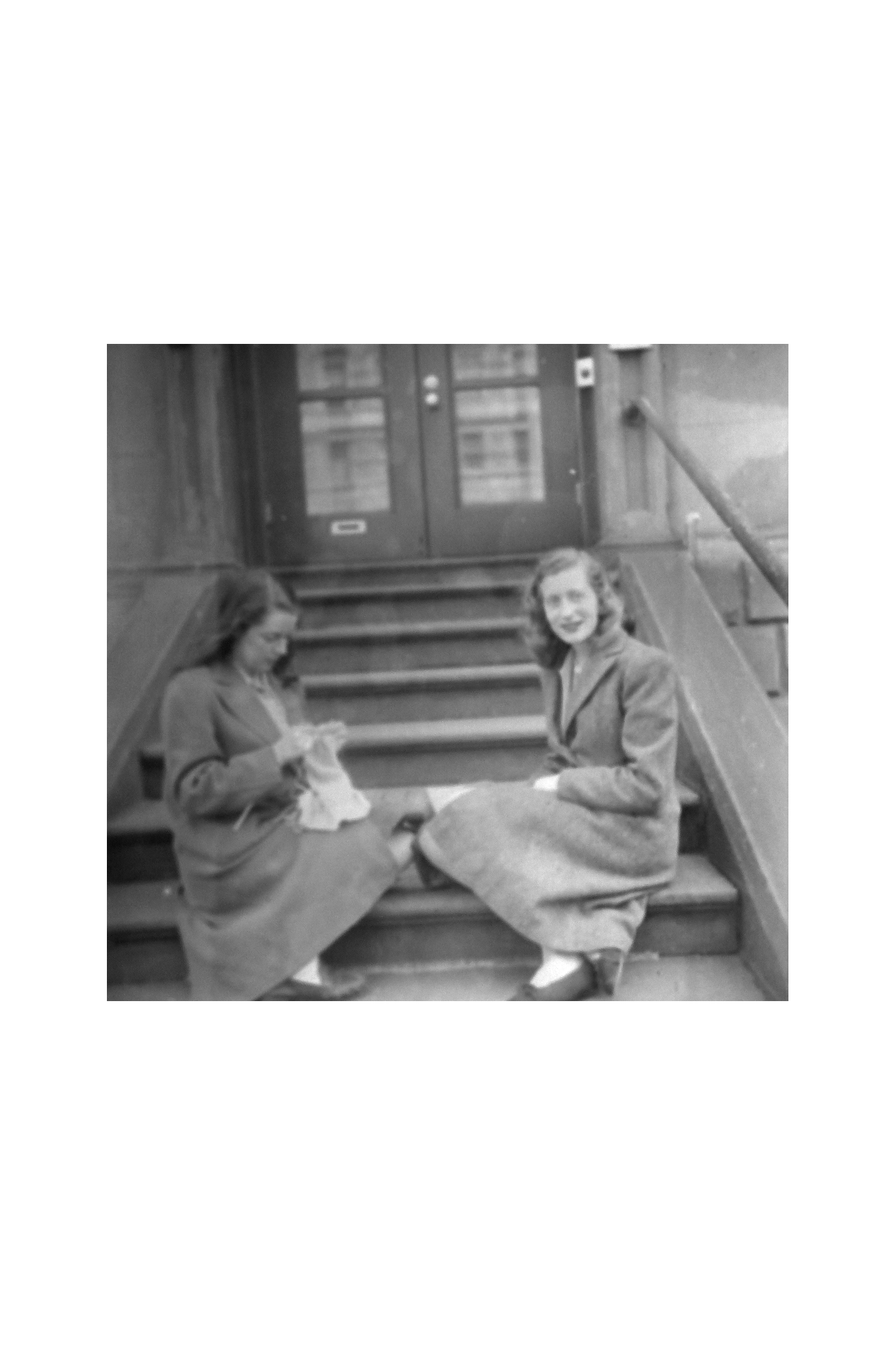

An old thrift shop Rolleicord has an exposed roll of Verichrome, the brownie era type, with the ink backing paper.
I, of course, will want to develop this roll. It turns out the prior owner was connected to N,Y, high society!
I have only R09 and Caffenol on hand, and can do stand development:D,
The old Verichrome issue has been covered before (use K vintage chem,), here, but what is my best way to proceed, with my chemistries?
Beside my limited chemistry, generally, what are the leading principles in dealing with film this age?

A few years ago, I developed a roll of found Verichrome from a Kodak 3A and got some images. From the clothing the subject was wearing I guessed late 1950s or early 60s exposure date. What worked for me was HC-110 dilution H with a long development time (10+ minutes as I recall). I've used R09 stand developing for some old b&w films with mixed results; I liked the HC-110 better.

I've had great luck with old Verichome Pan dating back to the 50s. But I would not recommend stand development. My "go to" is ID-11 or D76, 7 minutes with agitation every 60 seconds. IF you can't get an image out of some photographic material using that regimen, then probably nothing will work.

Well, tried to mount this very old film onto the Paterson reel, and it is giving me a very hard time, having been coiled tight for so long.
It would also have been nice if I had locked the reel in place correctly, as it collapsed in, on an almost successful first try... lesson learned!
Could I try to coil the film the opposite way, let it sit a bit, hoping it would at least allow me a fair chance?

After first failed attempt to get on spool, I soaked my film in room-temp. water, for an hour+ or so.
Out of the tank, film looked whitish, and Jello-like, under safe light.
Did emulsion just dissolve?
I decided to let dry overnight, and today, first thing in the morning, got it to go on spool, more or less.
So, who knows what will come out, if anything?
Note: this very old film's paper backing is pink, was red originally, I think
The untreated film cutoff, by the tape, is raspberry-red, with some small blotches.
Udpate: Rodinal 1:100, one hour stand developement, as per recommended by a forum member, it worked!

Five or six frames exposed, I see long dresses, so before the mini-skirt era!
I agree, hair and dress style suggests post-War, but by less than ten years, probably 1948-1954. A couple years later than that, they'd have had different shoes, different hair, and likely shorter coats over skirts.

There are five usable shots. The sample above was just a quick take of the light box, so I can scan them and adjust in GIMP, and post here.
I can't believe I pulled something out of that film - and my safe lights work!
