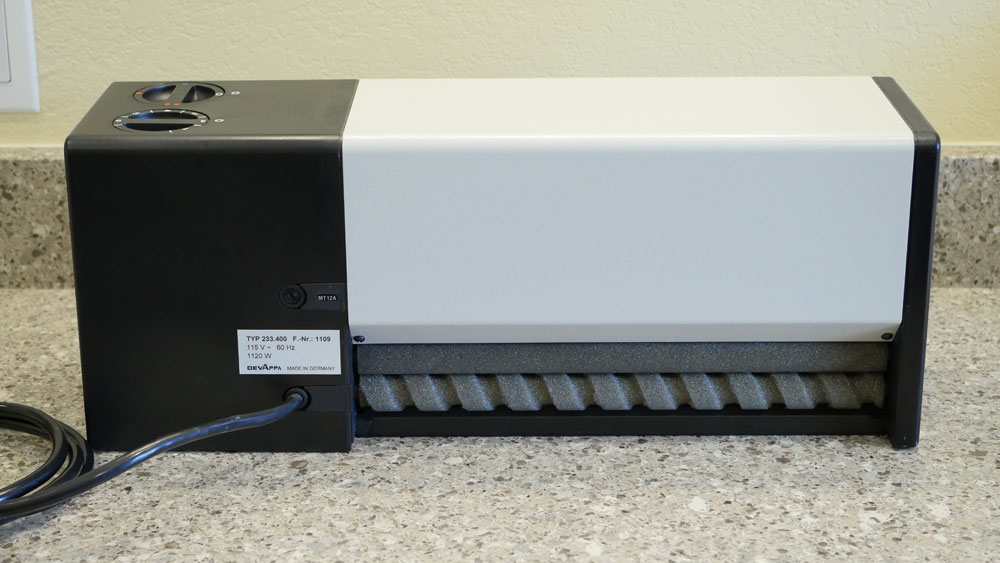

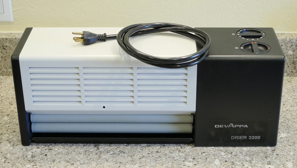

I've got one of these DevAppa driers. It's a very nice, incredibly well made and compact drier just for RC papers. Been using it for twenty years, mine is still in perfect shape with no deteriorating rubber and the foam rollers are intact. The size is what sold me on it as it is very easy to store away and it does not need a lot of counter space in use. It was made in Germany and mine was imported and sold in the US by Jobo. It's not infrared. There are two heat settings and the rollers can be steplessly set to any speed you wish. Its one and only drawback is the small size of the drier means there's no long drier tunnel so sometimes a tiny drop of water is left by the rubber rollers on a corner of a bit of paper. If you stack sheets immediately out of it, they can stick. It does dry paper in a few seconds, but I still put the sheets on fiberglass screens just to finish the process. Been using mine continuously since the early 2000's and it's still going strong.
Edit: they also run very quietly, which is really nice in a small room.

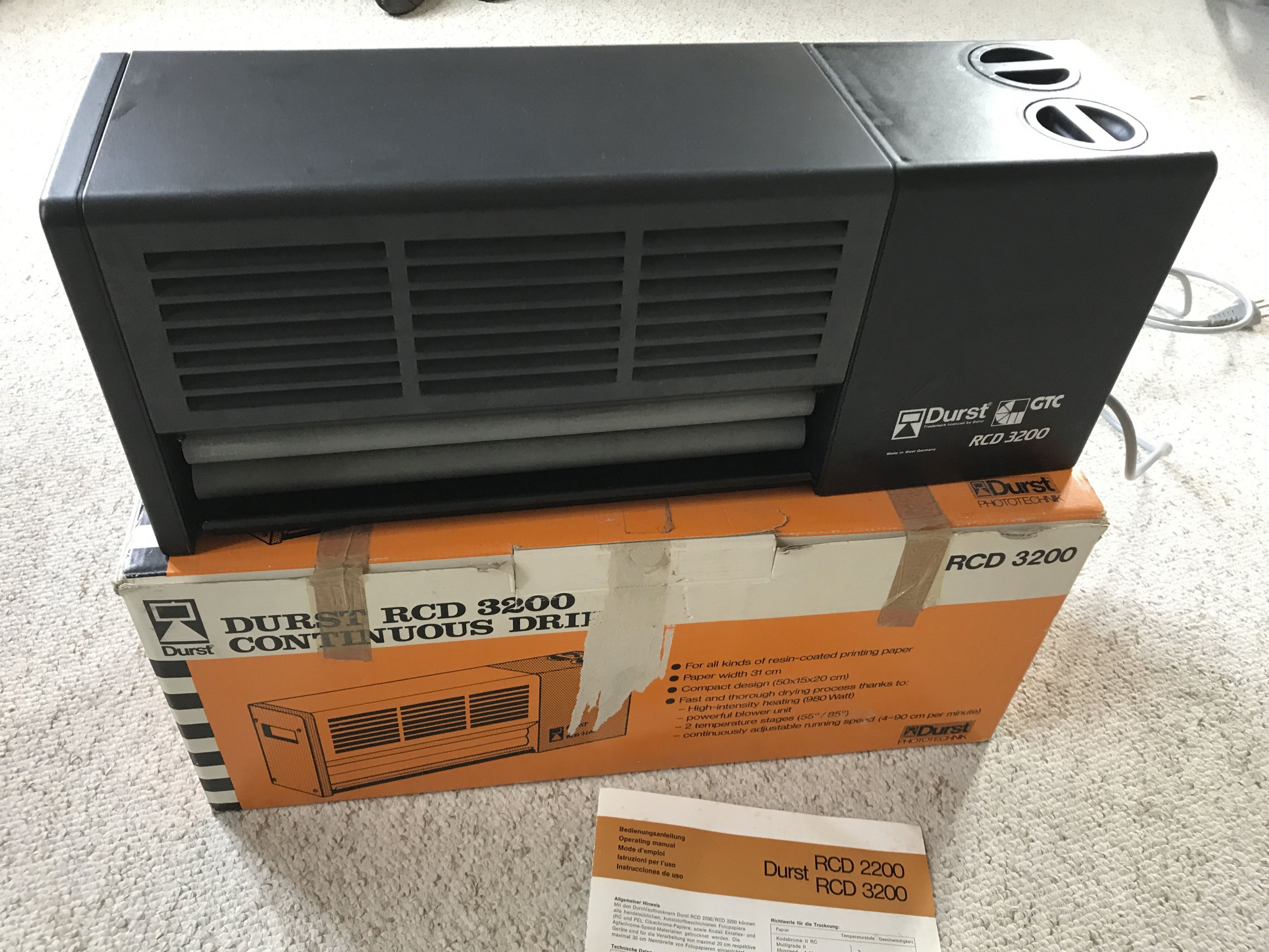

In designations of dryers as RC (Kindermann) or RCD (Durst) the use is indicated.
