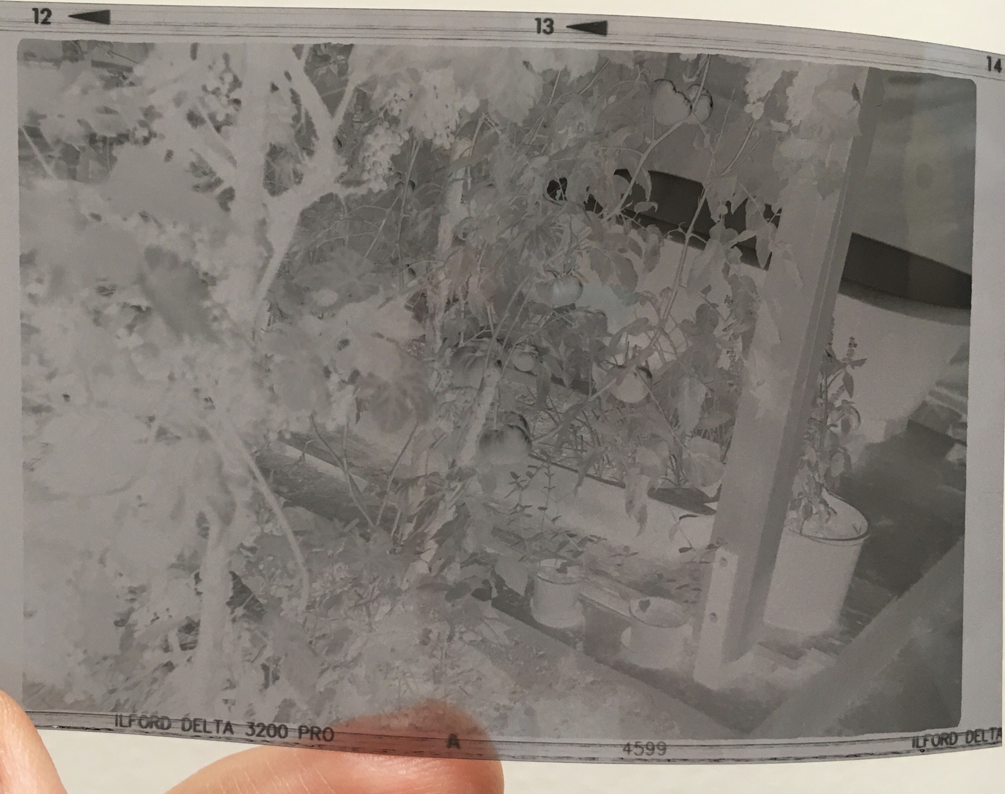

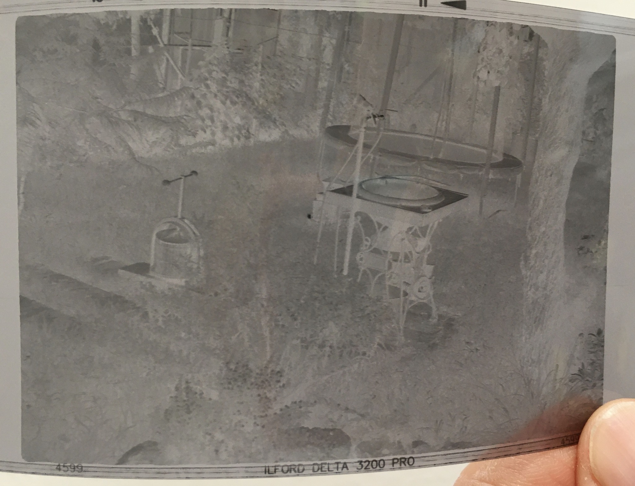

So I made an experiment with my almost 90 years old folding camera and developed the negs 1:50 for 24 minutes. The results are nice though a bit faint (sorry that I only took a photo with my phone). Maybe it needs a few more minutes. I shot it at 1600 and developed it as 3200 as always.
With Rodinal, developing times deliver an almost exponential decline in returns once you go over 20 minutes - and are pretty pointless over 30 mins. I'm not really sure what is stopping you using 1+25...
Those negatives look to be quite printable.
