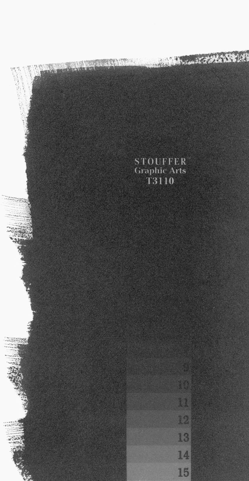

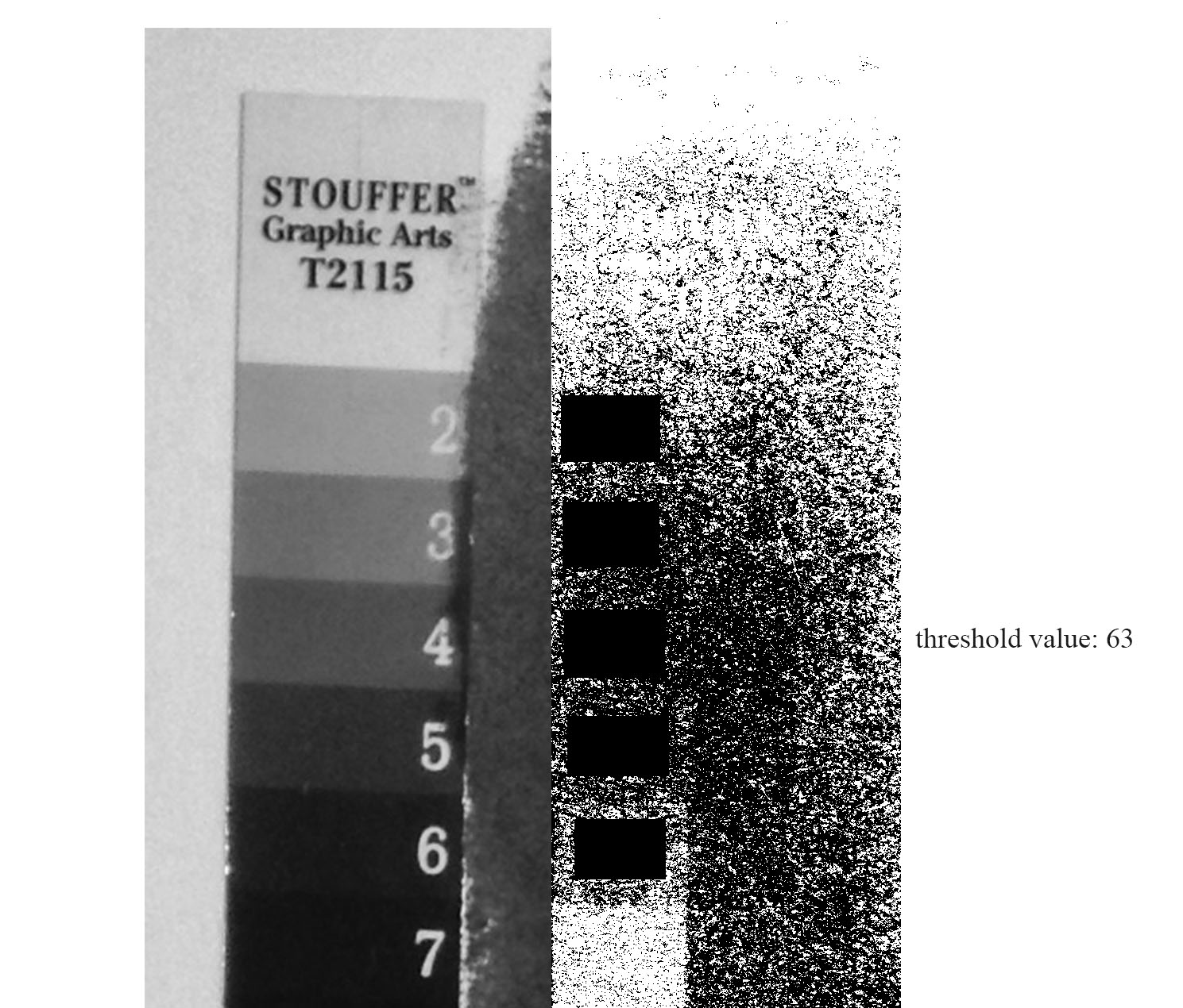

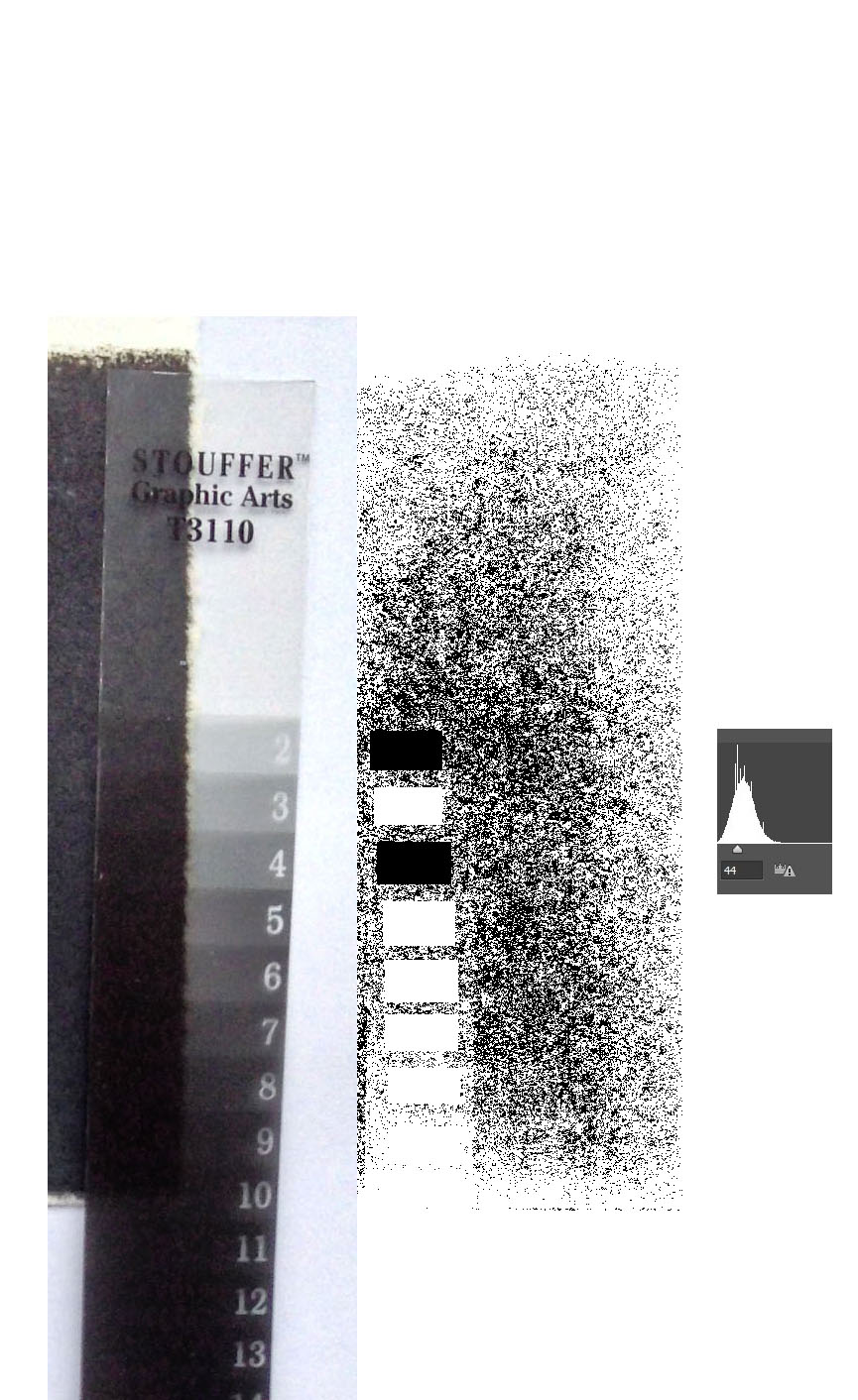

Loris, I'd like to say sorry first for the questions I'm going to ask. Is "Average tool" in PS? I can't figure out which one it is. Also I don't understand how to use the levels or treshold tools to assess merging. Why not eyedropper to read K values and make comparison?
Loris Medici
Sep 13, 2005
1,154
Istanbul, Tu
Hi sudek. It's under Filters -> Blur -> Average. Treshold or Levels is easier to see if there's any merging step or to see which one is the darkest step - all at the same time. Do as I say (average each step - paying attention to not include the numbers and to keep the selection area always in a single step, desaturate and put a treshold or levels layer on top of the image) then fiddle a little bit and you'll instantly realize what I'm talking about.

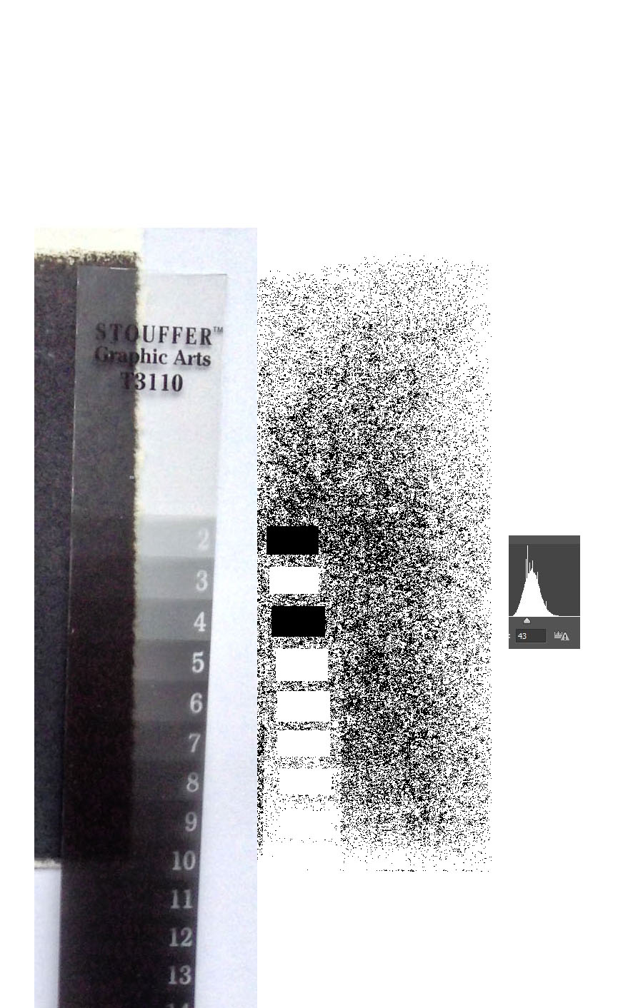

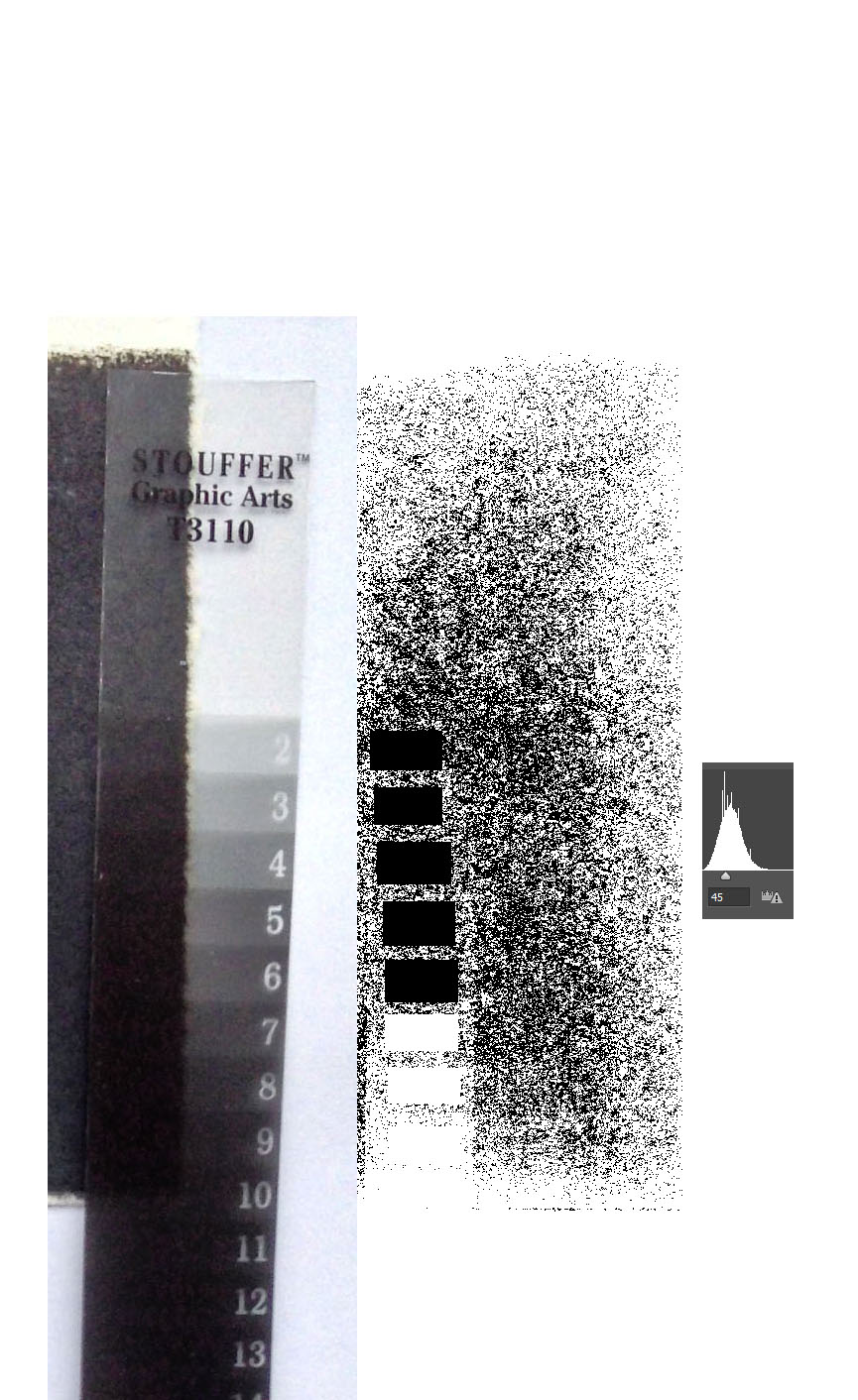

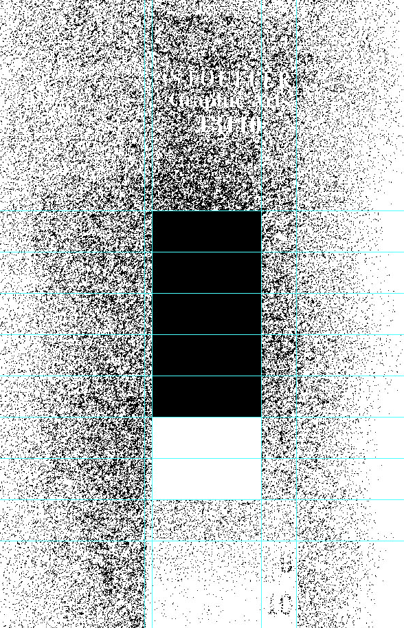

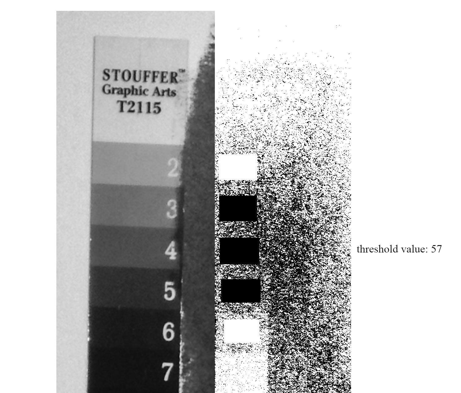

Loris,thanks much for the detailed instruction. I scanned the 31 step tablet exposed for 40 minutes and did exactly what you've taught.When the treshold value was 43,I got step 2 and 4 turn to black simultaneously,while at the treshold value of 45,step 3,5,6 turn to black simultaneously.Is it abnormal?
Loris Medici
Sep 13, 2005
1,154
Istanbul, Tu
Hi Sudek, if there are more than one steps turning black with a single RGB step adjustment, then you can safely assume they're in fact merged steps, "if and only if" there aren't too obviously distinct to your naked eyes - "in natural viewing conditions". Send me (privately) the RAW scan of your step tablet print. (All of the step tablet under OHP material would be better, if you have one.)
Don't know what's going on when you further increase the blackpoint but if you don't get further merging steps we can assume that you have dmax (a convincing black) under step 5.
Can you read the number of step 5? (Makes sense only if tthe number also was under OHP.) If you can't read / differentiate the number, it can be considered dmax.

The problem is due to the fact that the process has self-masking and bronzing / solarization (when grossly overexposed). This two phenomena may lead to not being able to have any merging steps in the step tablet prints. If you're only looking for merging steps to find the dmax, that may lead you to confusion - just like sudek's case. It's simple actually; look not for merging steps (if you have them it's allright), just grossly overexpose and look for the darkest step.
sudek
Sep 15, 2013
38
8x10 Format

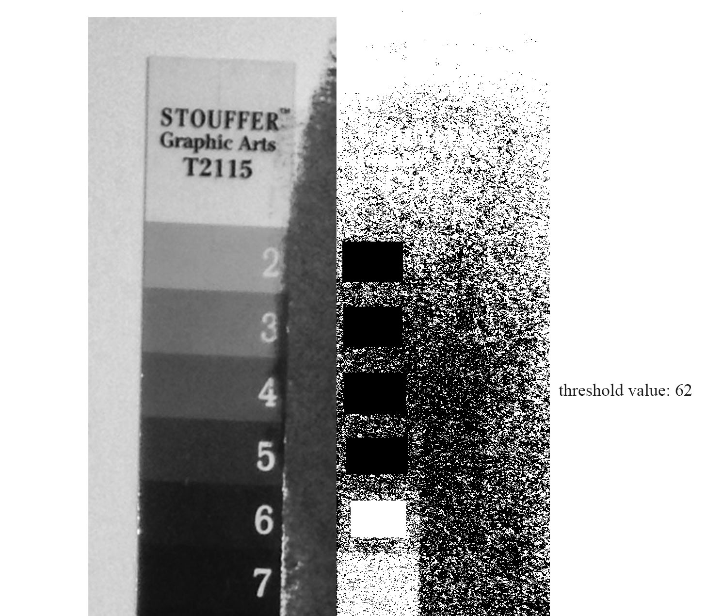

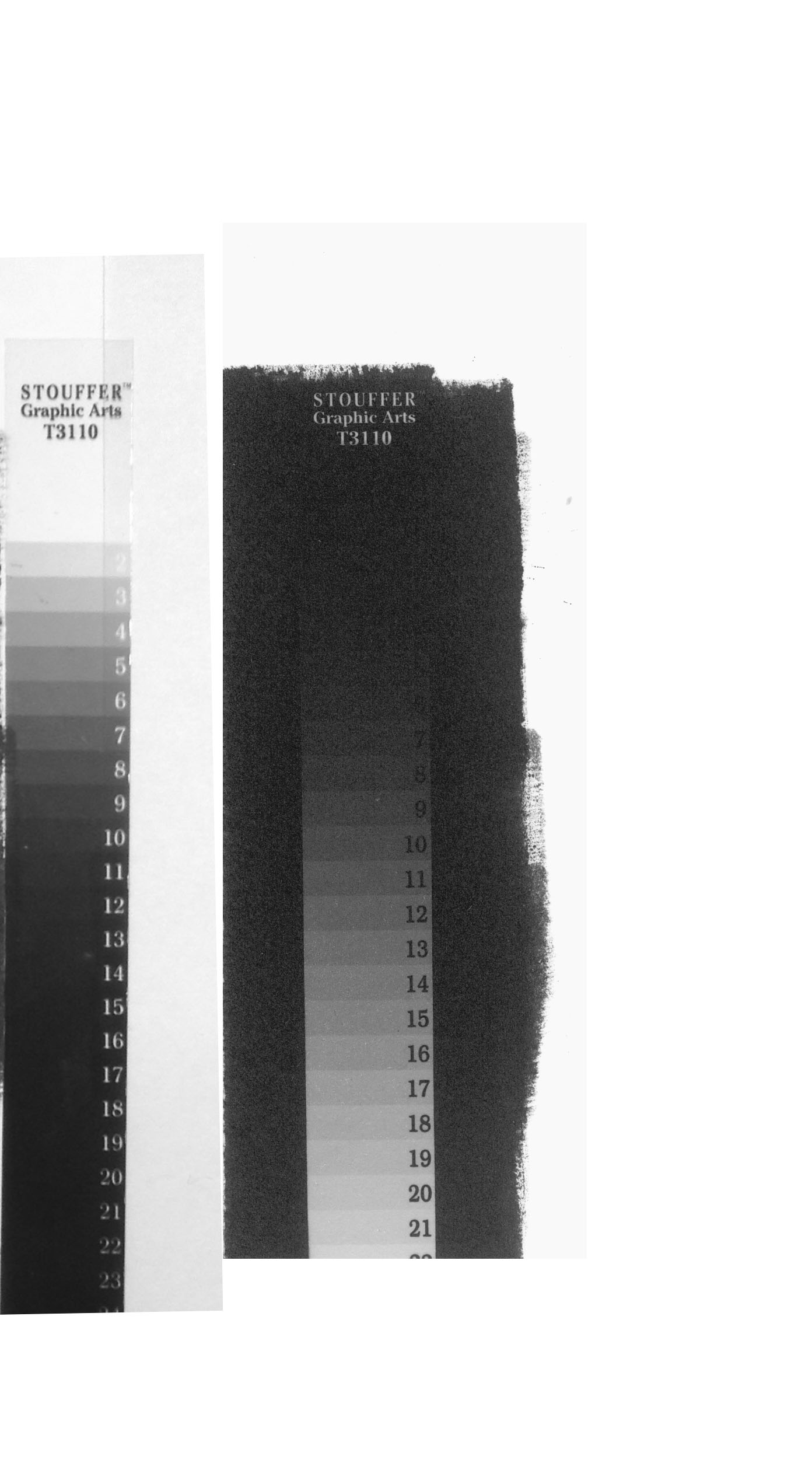

Loris,as it seemed somewhat strange to me when I saw step 2 and 4 merged without step 3, I decided to expose for the same time to check if the result is consistent.So I exposed for 35 mins and 40 mins again,but I made new developer solution this time(I use Sodium Citrate as deveoper).And it was so astonishing......so the developer that can be used forever is only KO? It made such a big defference. On the strip exposed for 40 mins,all the steps from 2 to 8 turn into black simultaneously,which means overexposure too much,right? For the 21 step tablet exposed for 35 mins,step 4 turns to black first,followed by step 3 and 5 simultaneously,and then step 2,and later on step 6. Could step 4 be consider Dmax then? According to the calculation method you mensioned above,I should decrease exposure by approximately 2 stops,right? For a 35 minutes exposure that means about 9 minutes?
P.S. Sorry that I forgot to have all of the step tablet under OHP,covering it on the part without numbers as usual.Should I send all the RAW scans or just the newest scans? Please let me know.Many thanks !!
Peter,the suggesion is not very realistic to me,thank you though.
Thomnola,I have switched glasses before and it doesn't seem to be the problem.Thanks a lot!

As for the the evaluation; step 8 (on the 31-step tablet / 40:00 minutes test print) is dmax. Since the evaluation was made with the test film + OHP, your actual dmax is at (virtual) step 9. (You count the step tablet as 1/3 stop...) You need step 1 to be dmax, therefore you have to decrease exposure by 9 - 1 = 8 steps. With the 31-step tablet each step is 1/3 stop. Therefore, you have to decrease your exposure by 8 steps = 8 * 1/3 = 2 2/3 stops, that makes: 40 / (2^(2 2/3)) ~= 6,30 ~= 6:18 - practically 6:20. (Remember, to decrease you divide, to increase you multiply...) Seems like a pretty typical exposure time with your exposure unit and OHP...

BTW, I don't see any patch beyond 8. Do you have a visual confirmation that step 9 is not dmax?

Loris,sorry to say that step 9 actually couldn't be seen on the tablet. I coated an area of 5X3 and torn the paper in two for the highlight and shadow steps of the 31 step tablet to save chemicals(ashamed that I've already wasted so much). I could have an integrate one for the 21 step tablet though. I'd do it again for a better judgement. Should I still expose for 40 mins?

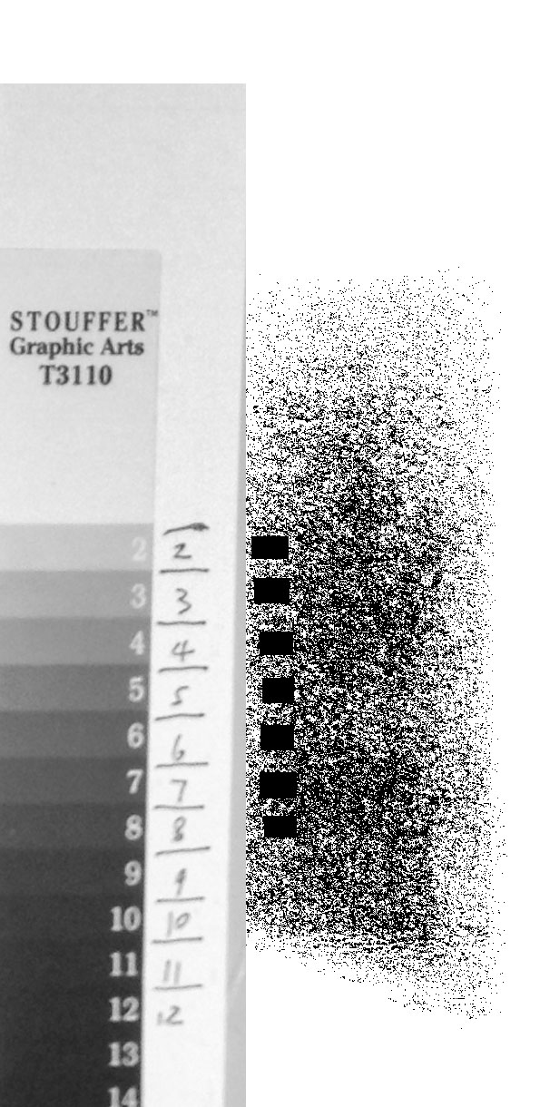

Loris,I just read the K value of each average step on the 31 step tablet exposed for 20 mins.
From step 2 to step 10, it reads as:90%,90%,89%,89%,88%,87%,85%,82%,79%.
From step 28 to step 31,it reads as: 8%,6%,5%,4%.
The paper white reads as 3%.
And for the one exposed for 40 mins before,from step 2 to step 8 all read as 83%.
If the steps have the same K value, does it mean that they're merged? And why the steps of the same K value can't turn to black simultaneously on the threshold layer?
Sorry for the childish questions. Many thanks!

Hi sudek,
When I process the same file, I see dmax exactly at step 3. (See the attached image... Steps 2 and 3 turn black together, that means they're merged.) Since the emulsion is under step tablet + OHP and you won't have the step tablet with real prints, the dmax is at virtual step 4. (Virtual, because there's no step tablet anymore. And the UV density of the step tablet is ~1 step with the 31-step tablet. Note: 31-step tablet has log 0.1 density steps, that is 1/3 stop difference per step. The 21-step tablet has log 0.15 density steps, 1/2 stop per step.) Since you want dmax at virtual step 1 you must decrease exposure by 4 (current placement of dmax) - 1 (ideal placement of dmax) = 3 steps. That is exactly 3 x 1/3 = 1 stop. Therefore, your standard printing time should be 20:00 - 1 stop = 10:00 minutes, (VERY IMPORTANT) as long as you keep all the process parameters (formula, coating volume per area, environment, processing etc.) the same.
Hope this helps.
Regards,
Loris.

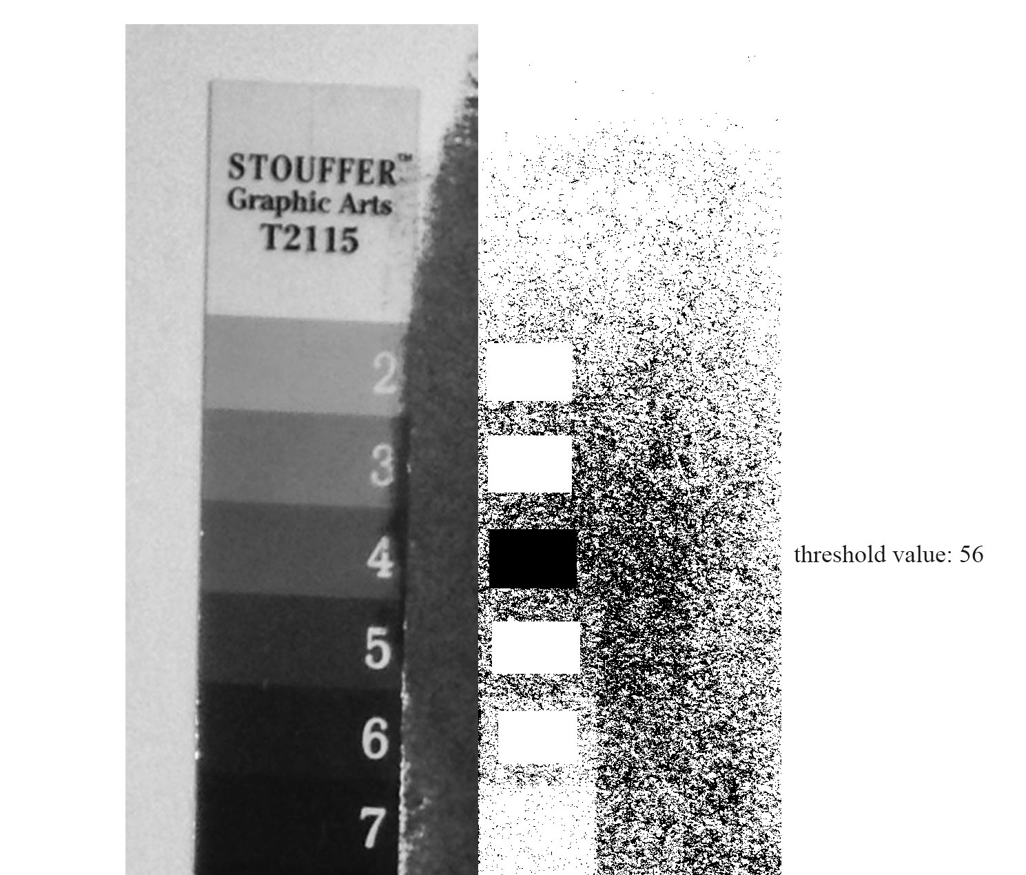

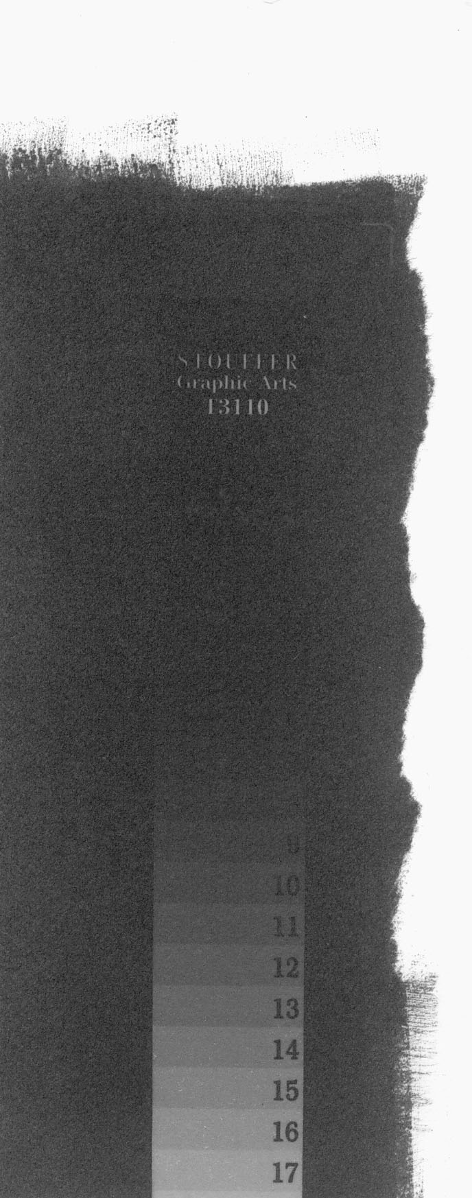

Loris,thanks so much for the kind suggestions.Sorry that I have questions again with the result coated by the "magic brush".
Is it abnormal that the uncovered part(neither step tablet nor OHP) on the coated paper got less density compared with the covered part? And it looks like solarization.I used 8 drops(4FO+4Pd) and 10 drops respectively and lower density on the uncovered part are the same.
And I found that if I drew different size of selection on each step,the result for the darkest or merged steps could be different,so did the K value.For example,with some size of selection,I got step 1 and 2 being the darkest and merged for the 8-drop strip.And step 1,2,4,5 the darkest and merged for the 10-drop strip.But the result may change a little bit for different size of selection.And I'm confused too on which strip I could based judgement,or neither? The TEMP/RH is about 18/60% for both strips,the previous condition (with the old brush)is about 17/64%.Does the RH variation matter? Sorry for all the trouble.
sudek
Sep 15, 2013
38
8x10 Format

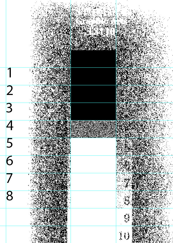

Loris,sorry that I just realized I should make selection according to the way you made it in your attachment.
10-drop strip: step 1,2,3,4,5 turn to black simultaneously.But the K value of step 6(85%) is the same as step 1,2,3,4,5.So the Dmax is supposed to be step 6?
8-drop strip: step 1,2 turn to black in order.But the K value of both is the same(87%).So the Dmax is supposed to be step 2?
It's so puzzling.Why are they so different? The drops are for an coated area of 4x5 inches and both of the strips are from the same piece of paper.
Loris Medici

Sudek, hi. Indeed with the 8d target, steps turn black in sequence. I didn't check the 10d target.
Few notes:
1. When coating volume per area changes, a very important process parameter changes. That's the reason for wildly differing results. *Use at least 0.25ml per 10 sq. in / 0.0039ml per sq. cm of coating solution*. Some papers will need a little less, some a little more, but those figures makes a very good starting point.
2. I see you still use a small area for coating, and the step tablet is very close to edges of the coating area. This is not a good practice; the edges often behave differently because coating isn't absolutely and perfectly even on the edges - definitely not a good place in a context of calibration! *Coat a larger area and keep the step step tablets at least 1-1.5" away from edges*.
3. OTOH, it's very hard to judge and mark the correct place with the standard Stouffer step tablets, because there aren't any helper marks on the negative, also the steps aren't equally sized. *I'd strongly suggest that you use Mark Nelson's tablets*. They're very nicely designed, you can discern each step very clearly because they're marked on the negative. And the numbers are readable in all steps. See the page, you'll understand why using these is considerably more productive...
4. Maybe it's time to consider a workshop; seeing a master at work will improve your grasp of the workflow immensely.
