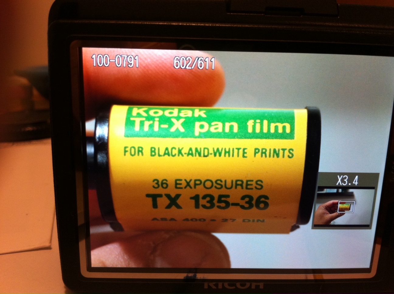

I found a roll of Tri-x pan film, ASA 400, and I want to shoot it. However I've never exposed this kind of film, and I have no idea how old the roll is.
See the picture below; can anyone estimate how old it might be by the print/design on the roll? It doesn't have any DX coding on it.
I've also never shot black and white before...so assuming I can figure out roughly how old it is, how would I go about adjusting for exposure? Pretty much all of my experience is in color negative films.

Welcome to APUG.
That film has an ASA speed rating printed on it, rather than the current ISO nomenclature.
That indicates it is at least 25 years old, and more likely older.
It has likely undergone at least some deterioration over that period of time. This means that it would be hard to predict whether it will perform well, perform adequately or disappoint entirely.
If you had a bunch of the film, and at least some indication that it had all been stored together, we could give you advice on how to test it for usability and how to modify your technique to take into account its age.
But without at least a couple of rolls to first "waste" on tests, it would be a bad idea to take any photos on it that might matter.
A fun experiment might be to shoot a new roll of Tri-X beside this roll, and see how they compare.

Looks like early/mid 70s. Then rule of thumb is usually 1 stop per decade, but I'd try shooting it at EI 100. Don't be quick to write it off though.

clayne gave a good estimate. I found old Tri-X speed was 64 once. So anywhere around 100 to 64 are good speeds to try.
This is why: Since the film is so old it will have very likely "fogged" with age. Fog makes the whole film look a little gray (you would get gray results if you developed it as-is).
So when you use exposure speed 100 to shoot it, instead of the normal speed 400, you overexpose enough to "rise above the fog".
In the end, your negatives will be denser than usual, and a little grainier. You print for longer exposure times, and effectively do not see the fog at all in the print (except for the grain it added).

I shot cassetts that looked like that in 1982.... the cassetts started changing to other graphics about 1984 then on to dx ect in the later 80's.

ASA and DIN were superseded by ISO in the mid 1980's around the same time as DX codes on film cassettes and negs was introduced. That would put your film nearer to 30 years old.

To shoot it at 100 ASA is a good idea, as has been stated before.
I recommend to process it using "Stand development" after that...

If it has a short (current) leader on it it is post 72 long leader pre but forgotten when they changed exactly.
Id stick it on eBay people will pay for nostalgia more valuable if you have tub and pack.
edit
if you wanna try load and shoot one frame rewind cut and soup in ID11 with added KBr and BZT.
Id not bother normally lots of fog.

I agree....if you're just wanting a film to use to take pictures (as against any particular interest in experimenting with old films), I'd put this one on Ebay as a collectors items, and use the proceeds to buy a fresh film. Old films are becoming very collectable.

My prudent suggestion is to do a 'clip test'. That will definitively tell you which direction to go.
In the dark, cut off about two inches of UNexposed film and place it on the film aperture of your camera (of course, in the dark). Shoot a scene with much variety of tones at EI 100. Process normally. Wash and dry. Now, with a magnifying glass and a white piece of paper behind it, scrutinize the negative carefully to observe both shadow detail and highlight rendition, as well as general contrast. You can make your final analysis for the film doing this.
About ten years ago I bought two 100 ft rolls of Tri-X that 'expired' in 1958. Its current speed is about EI 32 and fog is surprisingly manageable. It is amazing how good some really old B&W film can be. It's just that too many (most) simply guess and shoot the whole roll and then are disappointed. - David Lyga
