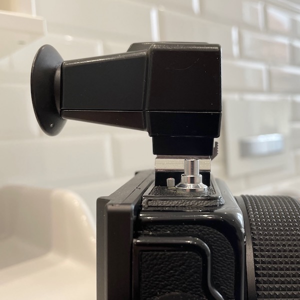

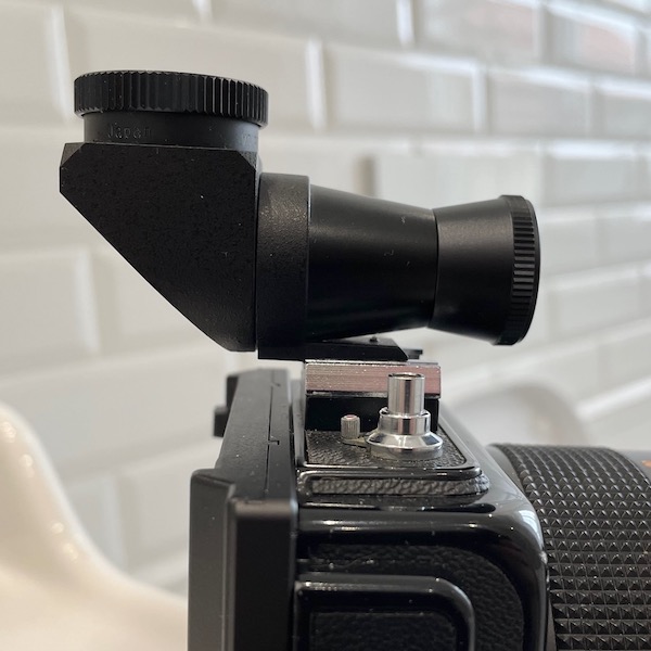

Voigtlander 35mm finder as is will mount on SWC. Foot plate is much smaller overall, shorter, but ends up in about where it needs to be in lengthwise direction, but lower. Since this mod is going to require internal alteration of mask, hence it likely can be matched to lower mounting position I still intend to make a new foot plate to match what Voigtlander supplied to 6x6 version of this finder (I estimate about 2-3 mm higher position, will need to get measurement for what they made though). The advantage of lower position is the closer optical axis finder/lens, so less parallax in closer shots.
