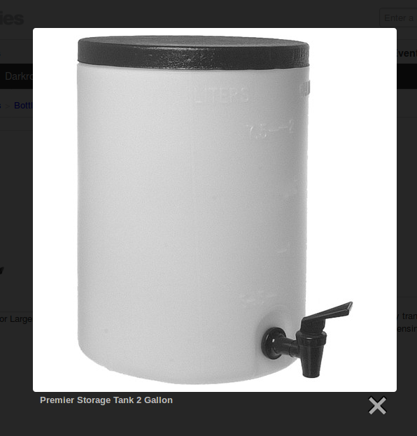

I have been using XTOL for the last 10 years. I used different bottles. Then I was done messing around. I bought this and it works fantastic. Do not use anything else. It stores perfect up to a year, because I pump in CO2 from my beer brewing stainless pressure tank so no Oxygen can get to it. ZERO issues. Got it at Freestyle for $36
8c30p
Your photo didn't load.
lol....operator error. trying it again...
This has worked for me and It's Great. 2 gallon XTOL. Before I close the lid I vent CO2 into it to keep air off the liquid. It does have an internal floating lid, so that helps too.
Greg
