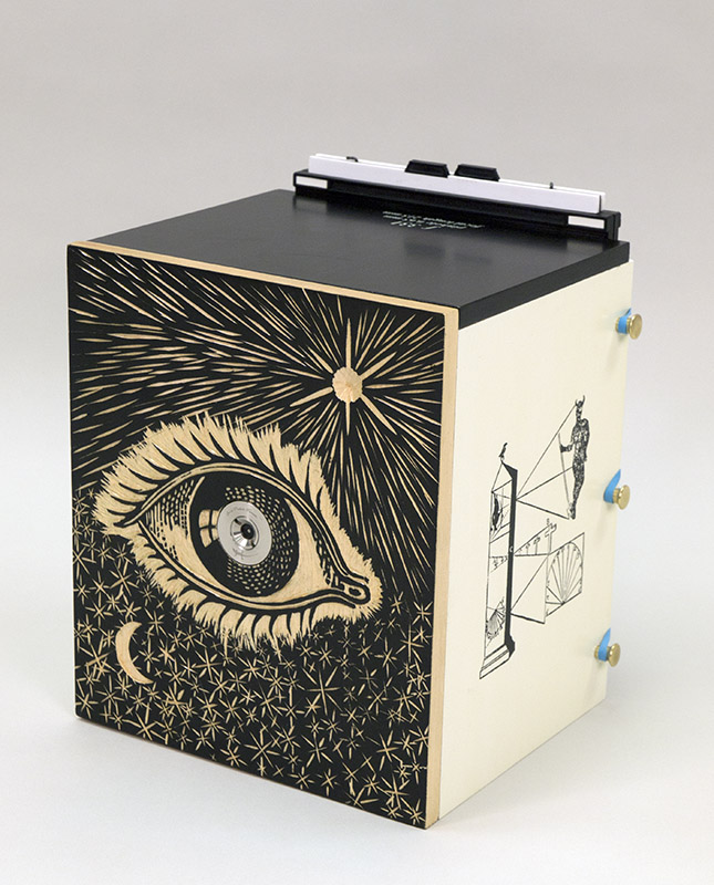

Here is a photo of one I built last semester. Would be happy to discuss it with you. I used a Skink pinhole and tripod mount. Bill Barber

Bill, I think I remember seeing pictures of that one before and it looks great. I really like how you hold the film holder to the back. Since I don't have access to power tools (just hand held ones that weigh too much for me to control), mine is constructed of foam core board and Ilford box tops. I'm expecting light leaks when I test it tomorrow. If my next door neighbor ever has some free time, maybe I'll see if he'd be willing to cut pieces for one like yours. Are you willing to give out the measurements and design?
Some screw hooks and rubber bands is all I ever use to keep film holders in place with my LF pinhole cameras. Send me your holder dimensions and I'll cut some pieces for you(though I dont forsee it getting completed by Sunday). I come down to the McKeesport/White Oak/Monroeville area every couple of weeks and will be there the first weekend of May(I was just there last weekend).

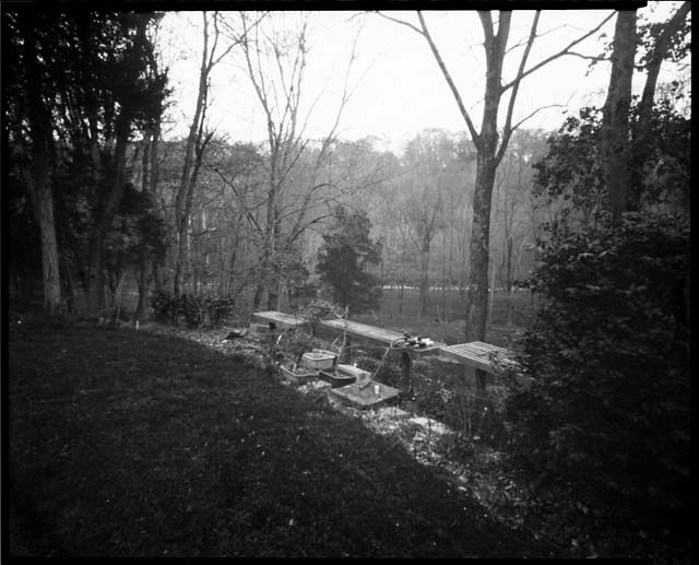

Just under the wire for WPPD -- my 8x10 design appears in my PBase galleries.
(Hope I'm not too tired to get out there with it!)
A scanned and inverted copy of the second test shot.
15 minutes on AristaEDU RC #2 graded paper, 4 minutes in Dektol 1+7. The exposure was dragged out, as by the time this sucker was ready to try, day was dying in the west!
Hopefully more will appear elsewhere after daylight ends tomorrow. :D

Compensating is an interesting idea (but complicated!) I disagree that it's the camera size, it's the angle of view. As you move off-axis, the round pinhole becomes an ellipse and ultimately narrows to zero minor axis dimension at points 90º off the optical axis. (In real life it happens well before that from mounting hardware, thickness of the pinhole plate etc.)
In my shot above, I think the fall-off is only minor. I'm on a wooded property and the sun was about 30 minutes from dipping below the western horizon. So all the trees and shrubs at the sides and foreground were in shadow while the wooded slope in the background was getting direct light.

Fall-off with pinholes in thin material is equal to the cosine of the angle raised to the 4th power. This means a pinhole camera with a corner to corner coverage of 90 degrees will lose two stops of illumination in the corner, or a bit more if the pinhole edges aren't perfectly sharp.
