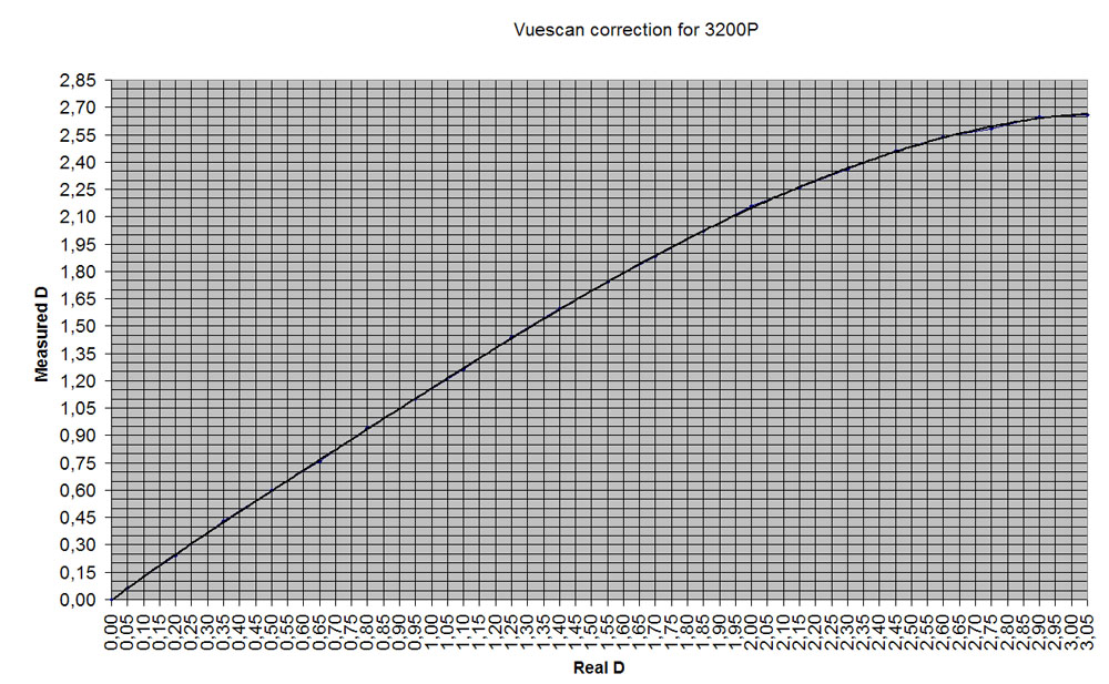

I've very recently discovered that if you have a good scanner you can use it as a densitometre using software as VueScan and probably Silverfast.
I still have to do it, but using calibration target slides such as those sold by Fuji, Kodak or Wolf Faust, and knowing the density of each patch, you can make a graph reporting the real density and observed density. Then you can use your scanner as a densitometre.
An example which I found on the internet

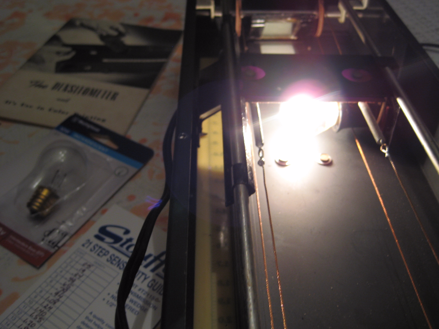

What kind of bulb does this thing use? Expecting delivery on Tuesday.

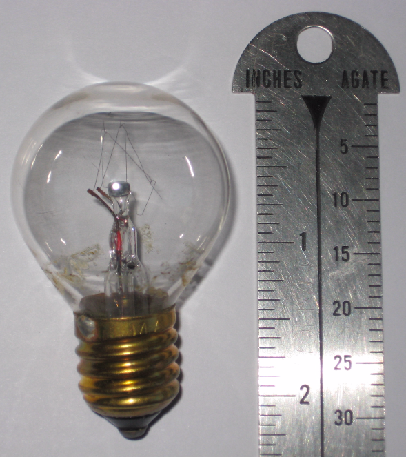

I picked up a couple to try from my local hardware store.
25 watts was too bright and too hot.
10 watts was just about right. It measured about a stop lower in intensity than the original, but the design of the densitometer doesn't depend on the actual intensity.
Bill, all of the transmission densitometers I've ever worked with directly, prior to the automated strip readers, used internal optics to project an image of the lamp filament into the measuring aperture. This relies on having a specific filament shape that has to be aligned properly when the lamp is replaced. Whenever we had a densitometer that kept jumping out of calibration, it was almost always due to a lamp with a damaged filament; the aperture was only partially filled (with the image), and using the densitometer caused the filament image to jiggle; periodically settling into different positions.
I'm guessing that some random bulb is not going to be right? Assuming that your densitometer works on the same principle. Anyway, it's something to be aware of as a possible issue.

Hi Mr Bill,
I've got a Macbeth that uses a tiny halogen bulb with a small flat coiled filament that I just happen to be able to pick up at the hardware store. That densitometer is sensitive to exactly where you position that bulb. When you get it just right, you can really see it is in the right spot.
But this particular one doesn't work on the same principle, you guessed it. The book that came with mine is dated 1940.
Anyway for hoots, I read a calibrated step wedge with the original bulb and changed the bulb to the 10 watt hardware store bulb. The standard deviation of my reading differences from calibrated strip is 0.0376 with the original bulb and 0.0348 with the new bulb.
If I throw out two lowest and four highest readings where the greatest deviations occur, I get standard deviation of 0.022 with the original bulb and 0.019 with the new bulb.
That's what my gut was telling me, that I'm within a couple points on average. For a primitive device, getting readings within a couple points is acceptable to me.
Now I could work on the tip regarding shape of the filament and making sure it falls in the place where it is supposed to be. I can see there is some shadow movement as I twirl the knob. I'm sure that's throwing off readings on the extremes of the scale.

For fun I put the 25 watt hardware store bulb in.
About the same results. Standard deviation of 0.0332 over the full range, and kicking out the extremes 0.0214.
It's based on the principle of the law of inverse squares. The light bulb travels on a pair of electric wire loops that bring it its current. It travels back and forth, kind of like the station indicator needle of an old school tuner. And you read the density off the linear scale.
The light itself travels two paths to your eye. From the back of the bulb to a mirror up to a piece of opal glass, up to another mirror and then along about a 15 inch tube past a lens and a piece of glass to a semisilver mirror. The semisilver mirror... of all things... is pointing down.
The other path from the front of the bulb hits a mirror pointing up to a piece of opal glass where you put the sample being read.
The really cool part is called the field mirror. It's a mirror pointing up to your eye, which has a hole in its silver.
The hole shows the piece of the film you are measuring while the field mirror is reflecting up to your eye the light from the back side of the bulb that had been directed down to it.
You turn the dial, like changing the station on that old tuner, until the spot matches the surroundings.

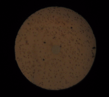

Here's what it looks like on the inside...
And here's looking at a sample.
Hopefully ParkerSmithPhoto got a better field mirror than I did.
