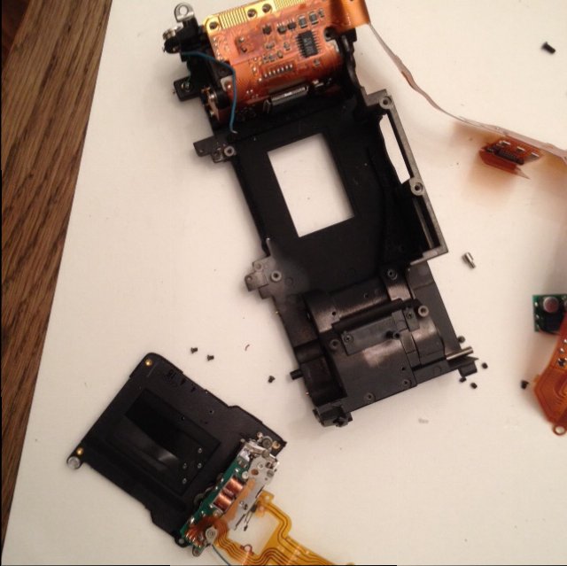

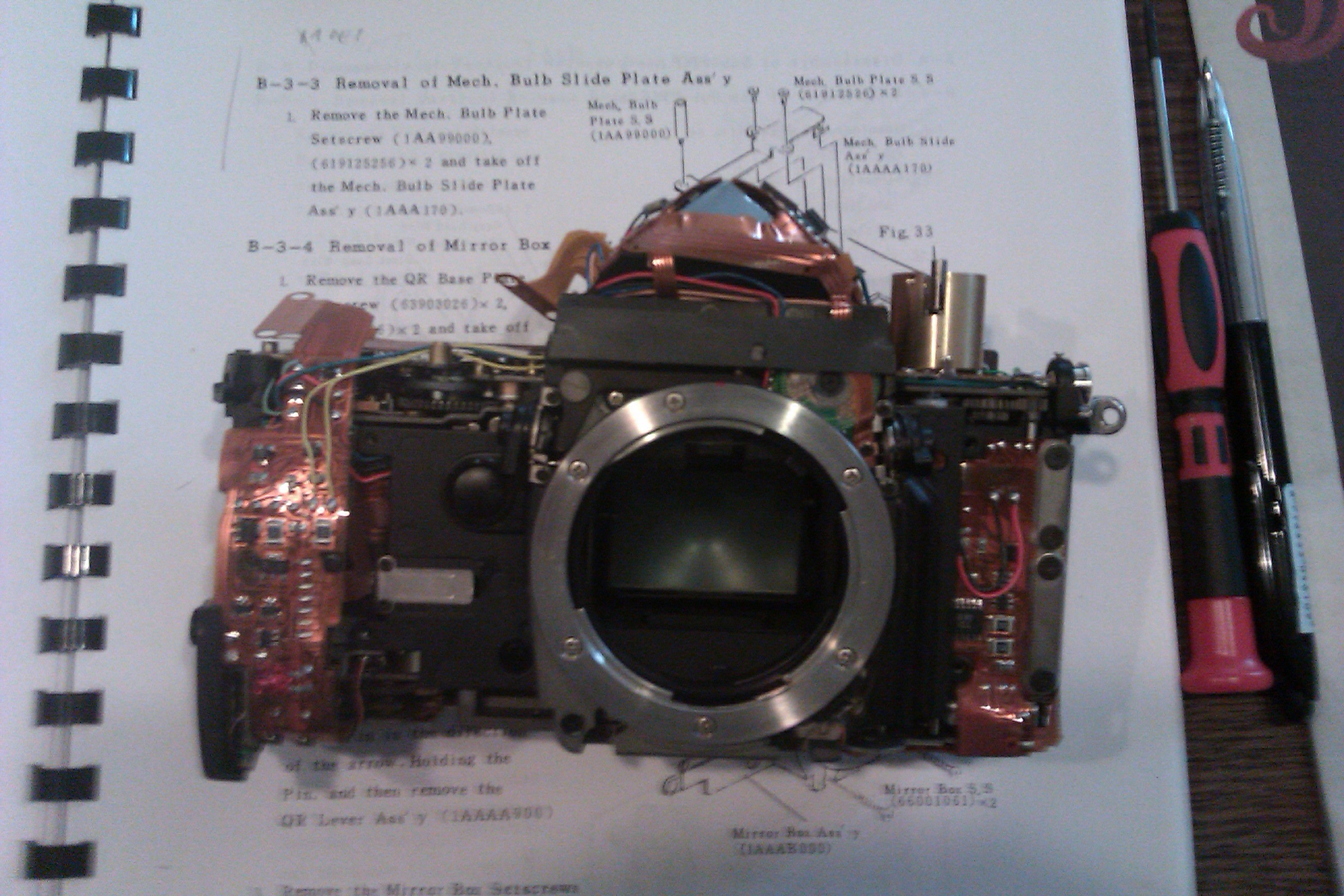

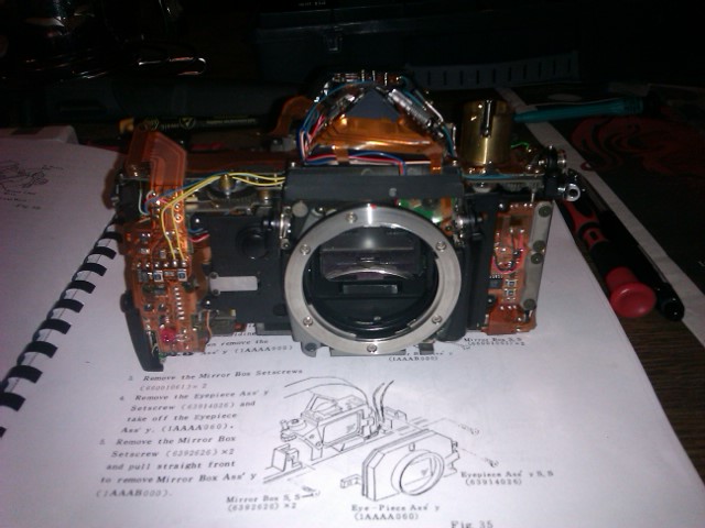

Today I started an attempt to disassemble a Contax RTSIII body in order to replace the shutter. I hope I can bring this to a good end. So far, so good. I"ll keep posting on the progress, in case anybody is interested.:blink:

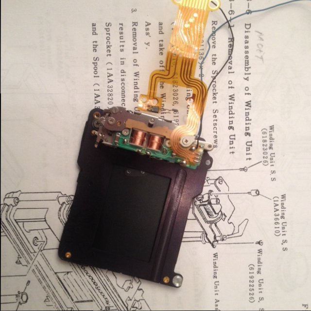

The donor-shutter is out. So far, I don't think I have damaged anything..

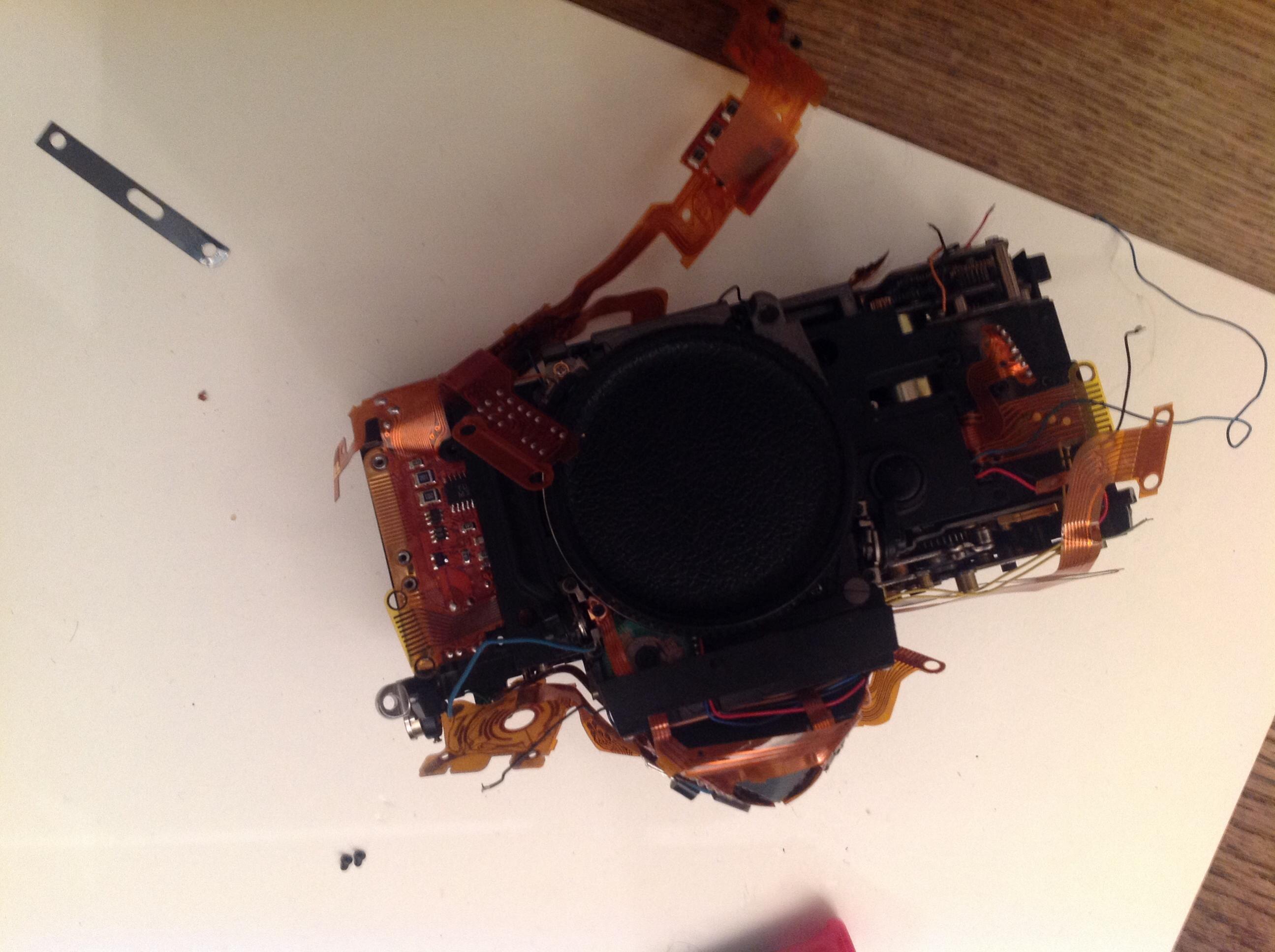

I have stripped a screwhead on the receptor camera.

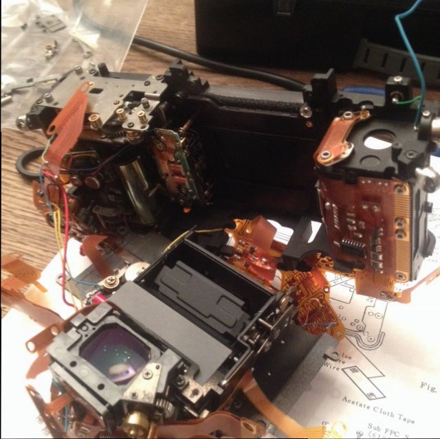

After battling a couple of stuck srcrews I finally reached the deepest inerts of my receptor RTS III. The broken shutter is out..
Reassembly-time.
