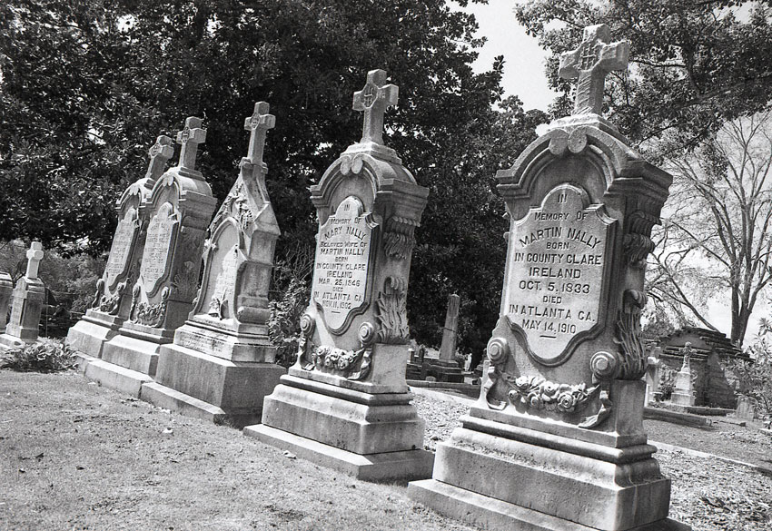

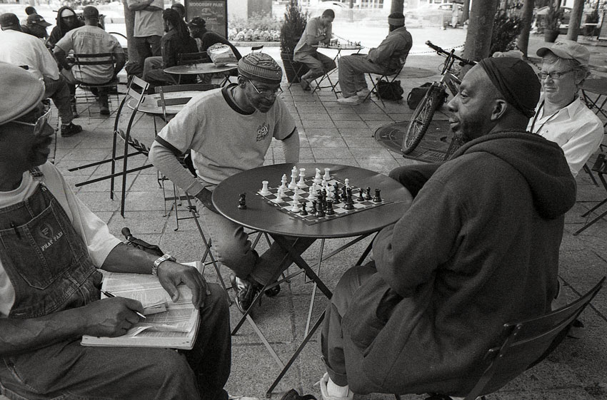

Ok here are a couple of shots. This film scans very nicely and has great tonal range. I have not decided if I like the grain.
Nikon FE, Nikon 28mm f/2.8

Your correct Tex but we were talking about a 1:1 dilution @ 75F which is 11.5.
I have already processes the film and it turned out great! It is nice film and scans really well too. It just has a tad bit more grain than what I have used in the past. But I like this film well enough that I am going to shoot some more and see how I like it after more experience.
I like the contrast and tonal range. It is really sharp. If you look at the twp photos above you can see it is sharp!
