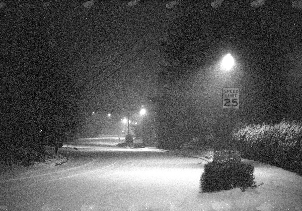

I just developed a roll from a challenging outing with my Canon F1. Granted, the hardware is not proven to be as excellent as my recent work with a Leica M6 (we won't talk about the film loading whining) whose center weighted metering has proven itself.
Anyway, Kodak strongly recommends 5ml of HC 110 syrup for each 35mm roll of film. Dilution e results in < 5. The results of development are... um, bad. Don't do this to yourself:
Kodak's recommendation is 6 ml per 135-36 roll.:D
6!!!
That means I've merely underexposed the film. Oh that Canon F1. Can't trust those long retired engineers :smile:
No, it means you were working with even more exhausted developer!

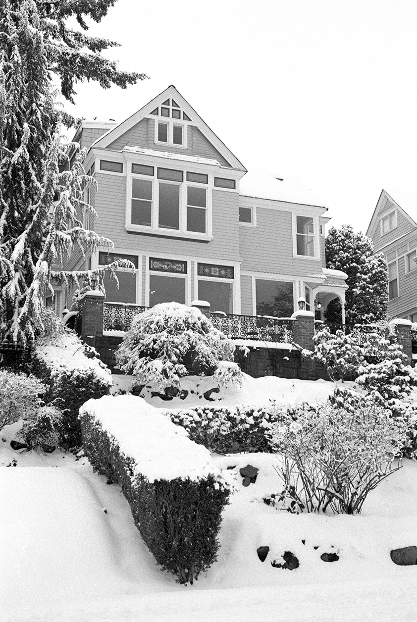

the other roll in the can: I processed a 2nd roll at the same time as the cruddy Canon F1 roll. The 2nd roll was exposed the the M6 whose center weight exposure meter is the class of the field:
Oh shoot! This one looks good. Perhaps the real problem is that I don't know my own equipment. The F1 is fun and pretty... but its light meter is crap next to the M6?

Your two examples are really different. Did you use the F1 to take any daytime photos? Have you had the F1 serviced/checked recently - it is fairly old? Are you familiar with the metering sensitivity pattern on the F1 (centre weighted, IIRC)?
Can I ask what is wrong with the night shot in snow? It looks like a night shot in snow should, doesn't it?
