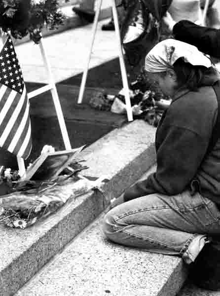

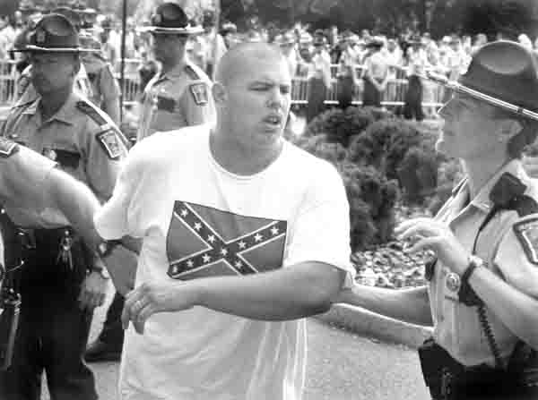

I have had pretty good luck with this film. I develope in Ilford ID11 at 72F for 9.5 mins. The paper is Ilford Mutligrade 4, Burke and Jennings developer, from Steve Anchells "Darkroom Cookbook" IE 1600. 120 size
The samples given are from a KKK rally at our capitol. A bright sunny day shot at F16 500th-1000th of a second. This is the only film I use when doing street photography.

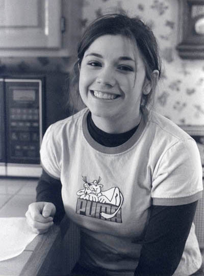

Dear htmlguru4242,
I find that both TMZ and Delta 3200 work well at 3200 in Xtol full strength. The grain, while not small, is quite smooth. I hope I have attached an example properly.
Neal Wydra
Sorry I goofed the picture with the gal kneeling was on a rainy day. Shot at 60th F8. Still had pretty good shadow detail.
