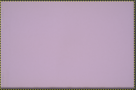

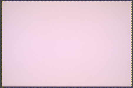

In case you were interested in how Delta 3200 film base looks when compared to HP5 in a staining developer (510-pyro), I have these examples on hand taken at the same settings from my last development:
Note the different formats which might make this a bit apples and oranges. But I never use Delta 3200 in 35mm.
Delta 3200 (120) .................................................................................... HP5+ (35mm)
View attachment 417151 View attachment 417152
Very interesting. I would say the difference in darkness between them is very similar to what I saw in my 400 ISO negs vs Delta 3200. Thank you!
