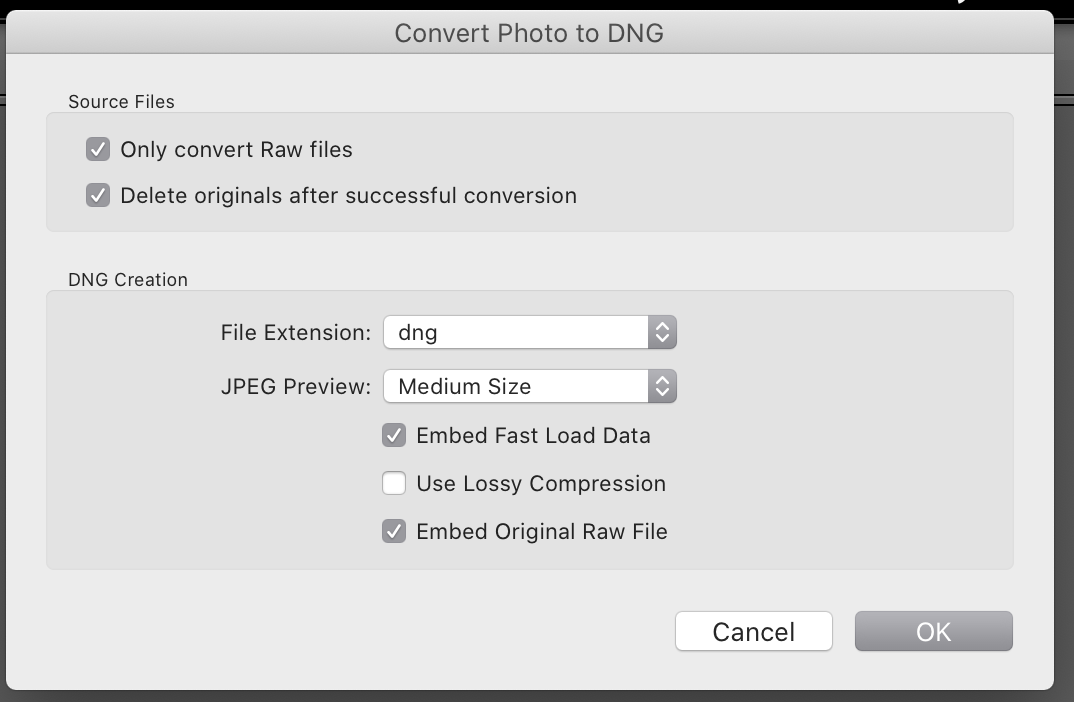

because DNG is Adobe Lightroom’s native format. DNG also lets you store the image as a CFA array instead of full RGB, which means smaller files. DNG also stores all of your edits in the file non-destructively, so you can pass just the DNG file around and all the edits go with it. AND, DNG is in fact a TIFF file.
So your scan is a "raw" tiff with the edits listed separately that LR can then interpret or remove in my machine's Lightroom v.6 licensed rather than a tiff where all the edits are built-in and non reverseable?
yep. To be clear, the edits in question are edits done in LRs Develop Module. The process of generating the initial positive image from the raw camera scan involves a fair number of operations that LR just doesn’t do, at least with my process. My goal is to deliver a positive image that looks and behaves just like any other raw DNG with the full toolset of ACR/LR at your disposal. What you get is a raw positive image that works exactly the way you’d expect it to in LR, just like if you shot that same image on a digital camera and pulled the raw images into LR and had LR convert them to DNG files. The difference you shot it on film and have the actual physical image.
On my own scans, I save all of them in Tiff, whether Epsonscan made any edits during the scan process or not. Then I use LR to edit. Assuming I could save scans in DNR (don't know if I can with Epsonscan), what advantage if any is there when I open LR?
for anything Epson scan generates, there isn’t any, but you can tell LR to convert your TIFF files to DNG and gain a fair amount of portability for your LlR edits. If you keep them as TIFF files, LR will store what edits it can in the standard tiff metadata, and the rest in the LR catalog file. If it’s DNG, it stores everything in both places.
Wouldn't that take up twice the data storage?
Hi Adrian,
Are there any other file storage formats that share similar advantages. I avoid the Adobe products - mostly Corel here.
I note that I can read DNG files, but I can't write them.
Hi Adrian,
The short answer is use TIFF files and your software of choice. The longer answer is:
Technically, DNG files are TIFF/EP files, so really any software that supports TIFF files and can read/write TIFF/EP files could do the same thing. My code uses the open source tiff lib to generate my DNG files. The only difference between LR and other software, is LR writes the Develop module stuff that is specific to LR to a set of TIFF tags that are specific to ACR/LR. Any software can read/write those tags and do the same thing that LR does. It's all in TIFF meta data tags that everything can see. There's no secret going on under the covers. Adobe isn't being some evil corporation that wants to lock you into their secret file formats. They are simply providing superior software functionality and user interface layered on top of standard file formats that are widely supported by lots of code libraries. Why other software out there isn't following suite and doing the same/similar is beyond me. If LR were to go away tomorrow, I'd be beating down the door of their next closest competitor and demanding that they start implementing the same/similar functionality that LR has, and use the same tags that LR does, and/or go off and implement my own version of LR that does the same thing.
For example, a DNG file in my LR catalog, as seen by the absolutely awesome and freely available exiftool:
The juicy Lightroom bits are down in the [XMP-crs] tags bit. There really are no secrets with what's going on with this file. If I really wanted to, I could use exiftool to write in some changes to the XMP-crs structure (say add some points into the 2012 tone curve for example), then go into LR and tell it to re-read the metadata for that file to pull those changes into the develop module. It would pull them in and they would show up in the Tone Curve panel. Why other software doesn't really do this is beyond me.
I cannot convert TIFF files to DNGs. Both Lightroom and Adobe DNG reject conversion of TIFF files. How are you doing the conversion?
[Edit: the only way I can convert is to invoke Export as DNG from LrC, after having imported as TIFF. The logical step to convert would be at import (Copy as DNG), but that is not possible.]
Uncheck "Only convert Raw files" in the Source Files section.
Thank you. I was hoping for a way to convert TIFFs to DNG upon or before import. I assume you have written your own code to do that. Converting after export (Convert Photo to DNG) leaves both tiff and DNG files on disk.
I’ve written my own code to do that. For your use, just import the tiff like you normally would, then once it’s in LR, select it, and do convert to tiff from the menu system, just uncheck that checkbox and it’ll do it.
