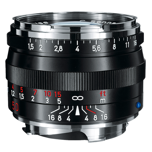

Hmm to prefer the Zeiss 35/2.8 ? In comparison to the Nokton makes no sense here from my point! To compare the Nokton 1.2 50mm with this Zeiss :
It is the Zeiss C Sonnar T 1.5 50mm ZM
would bring you into trouble from your budget it is more expensive!
