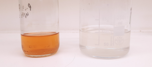

Here's my concentrate (part A) in glycol to the left, and a freshly mixed working solution 1+1+100 in tap water to the right:

I won't think so for now. I'll scan the first sample tonight, do another one with proper measurement and fresh film. But I'm really surprised by the 30 year old Ilford - there's no hint of fog and the sensitivity hasn't dropped much either. I found it in an old loader, it hasn't been refrigerated...
About the color of the working solution after processing - as far as I can tell, it is not from oxidation - it is caused by dissolving of dyes from the film. In the picture above, I had cut pieces of old technical film - Kodak 2498 RAR. Like most technical films, this one has a "strange" emulsion color - a strange greenish...

My working solution usually turns very slightly greenish in places when I add Part B then clears to almost colourless when mixed. Post development the colour is very dependent on the film stock processed green, quite dark blue, yellow, orange, quite a range depending on the anti-halation dyes used.
