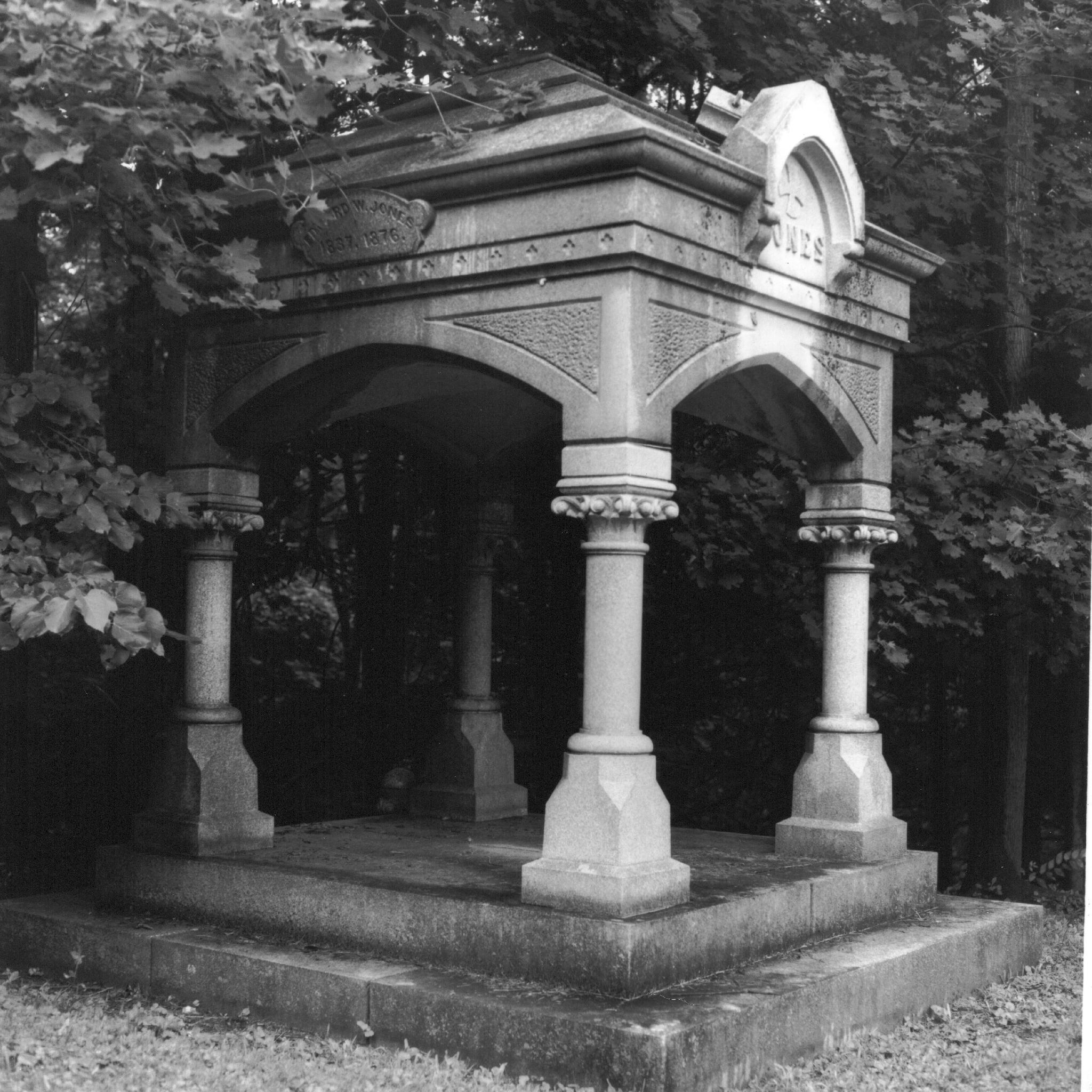

Thank you everyone for the replies . . I have learned a lot, and I am researching various techniques to make my printing efforts better and better. Being a retired Engineer (it's a curse) I find that I definitely lean towards perfectionism . . . :wink:
The two images are the original scan and my final print. AT this point I am pretty happy with it. I used the Beseler 23C II with el nikkor 80mm f5.6 lens, Contrast filter #2 exposed for 22 seconds at f22 on Ilford MG IV glossy. I used two sheets of 5x7 paper to dodge everything on both sides of the center column.
Printed at 8x8. Wish it had a little more "pop" like the scan . .
Constructive Criticism is greatly appreciated . .

You're well on your way.
Just practice and make notes.
Change only one thing at a time.
Remember to develop "to completion" for good solid blacks.
:smile:

Thanks E. von Hoegh. I develop in Dektol 1+2 for 90 seconds . . . is that enough?

I'd go a bit more, it's pretty hard to overdevelop paper. I think I was using 2 1/2 minutes in D76. As long as you're getting good blacks, plus a bit to allow for the devoloper weakening during a printing session.

E. von Hoegh, I edited my comment above . . actually I use Dektol 1+2 for my prints for 90 seconds.

"Pop" is somewhat over-rated :D.
As posted, some of the "pop" in the negative scan comes from highlights in the column that lack detail, whereas the print shows that detail. Subjectively, I find the print scan more satisfying.
90 seconds is in the ballpark for RC paper and Dektol 1+2. It would be marginal for FB paper.
It would be worthwhile for you to experiment with longer developing times, but be sure to use the same time for your tests and the associated final prints. You may very well decide to stay at 90 seconds.
And by the way, D-76 isn't used as a print developer by many people.
