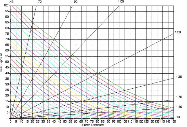

In this example (from my darkroom), a 90 second Green exposure gives the same mid-tone print density as a 45 second blue exposure.
The table shows, for example to increase print contrast from, say ISO(R) = 70 to ISO(R) = 105, the exposure would need to change from:
Blue = 85 sec; Green = 20 sec, to Blue = 58 sec; Green = 58 sec, etc, etc...
