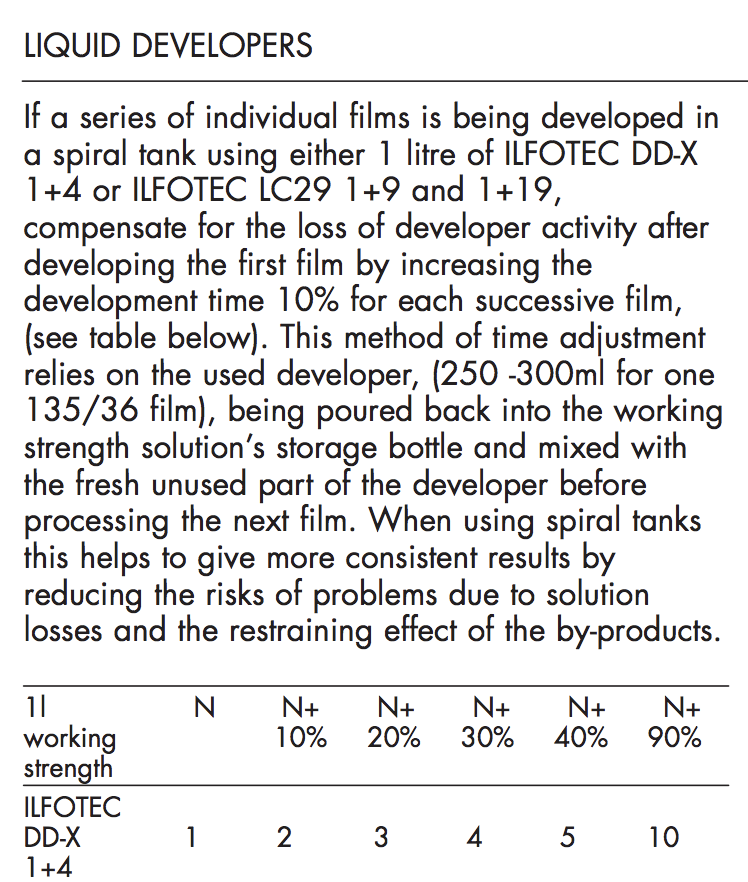

I process my B&W film in small two-reel manual tanks, so usually wait until I have two or sometimes four rolls exposed. I’m now planning a switch to DD-X to get as much film speed from Ilford Delta as possible. I’ve read through the data sheet for DD-X and understand that multiple films can be processed with a litre of working strength developer by extending the time by 10% per film, but I can’t figure out what to do with two reels in the same tank. Should I be:
1. Using the standard time with films 1 & 2, and +20% for films 3 & 4?
2. Using an average of the times? I.e. +5% for films 1 & 2, then +25% for films 3 & 4?
3. Not attempting to process two films at once with DD-X?
4. Something else?
I realise the ideal situation would be to develop only one film per run, dump it and mix fresh working solution, but at £20 for 10 films processed, its an expensive option. Have I just been spoiled with cheapo HC110?!

For clarity, this is the bit on the PDF I'm referring to.

1, 2, 3, or more rolls at the same time (in the same tank)= no change in development time.
This sounds like it would be the correct approach, but I'm wondering what to do with the second batch of two films? Maybe that's where I have to suck up the cost and chuck the developer? Process two in 500ml and mix fresh developer for the next batch of two films. At least that would bring the cost down to £1 a roll, which is acceptable given I'm looking for good quality and speed.
I always used DD-X as a one shot developer so have no experience to offer on how to extend it. Ilford gives pretty clear directions and I would just follow those.
Add 25% (halfway between 20% and 30%) extra time for the second batch of two films.
If your shots are all of scenes that will likely yield dense, high key negatives (snow scenes or babies surrounded by white), consider increasing the percentages.
Those percentage increase suggestions are likely quite conservative.
Thanks for all your help with this. I have a couple of months before I’ll be developing any important negatives, so I’ll give everything a test. I’m going to start with two rolls at the standard time and the following two at +25%. If nothing else, that’s easy to remember and simple maths.
