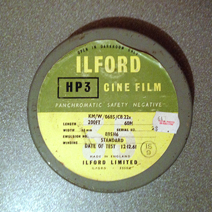

Can someone date this can of HP3 and the original speed? And any developing times for it? I assume it's a 125 version?
I'm looking for original developing times.
I want to treat it with halogen gas, bracket around the original speed and use an original developing time as an experiment.
By fortunate coincidence I dug out some information Ilford sent me a few years ago to answer another question on the forum about HP4. I still have it in front of me.
It tells me that HP3 was introduced in 1941 and it's replacement, HP4, was introduced in 1960.
The speed was 400 ASA (allowing for the fact that speed was calculated a bit differently in those days).
I've got some times for ID-11 and Microphen, but these are for 35mm , not sure if they apply to cine film?

I landed some of this film today, dated December 12 1961.
Yet to open to see if it is indeed the full 200ft; will be an interesting exercise if it is spooling-wise!
Would it be best to cut some short rolls and test at 400 and 250?
I've got D76 and Atomal FF developer on hand any suggestions for a starting time?
