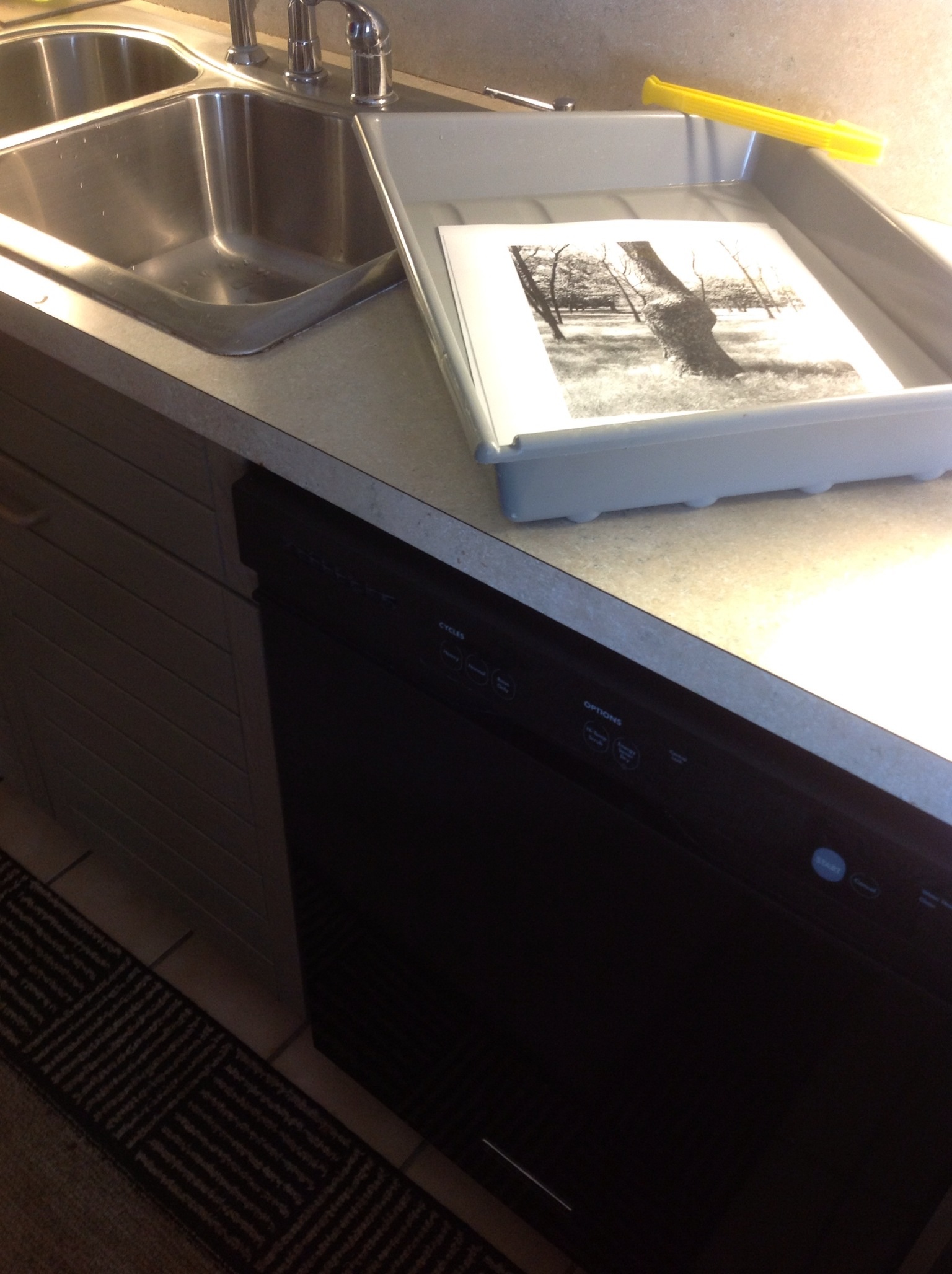

Access to water, temp control and disposal....this is the reality for most people.....the kitchen sink.
