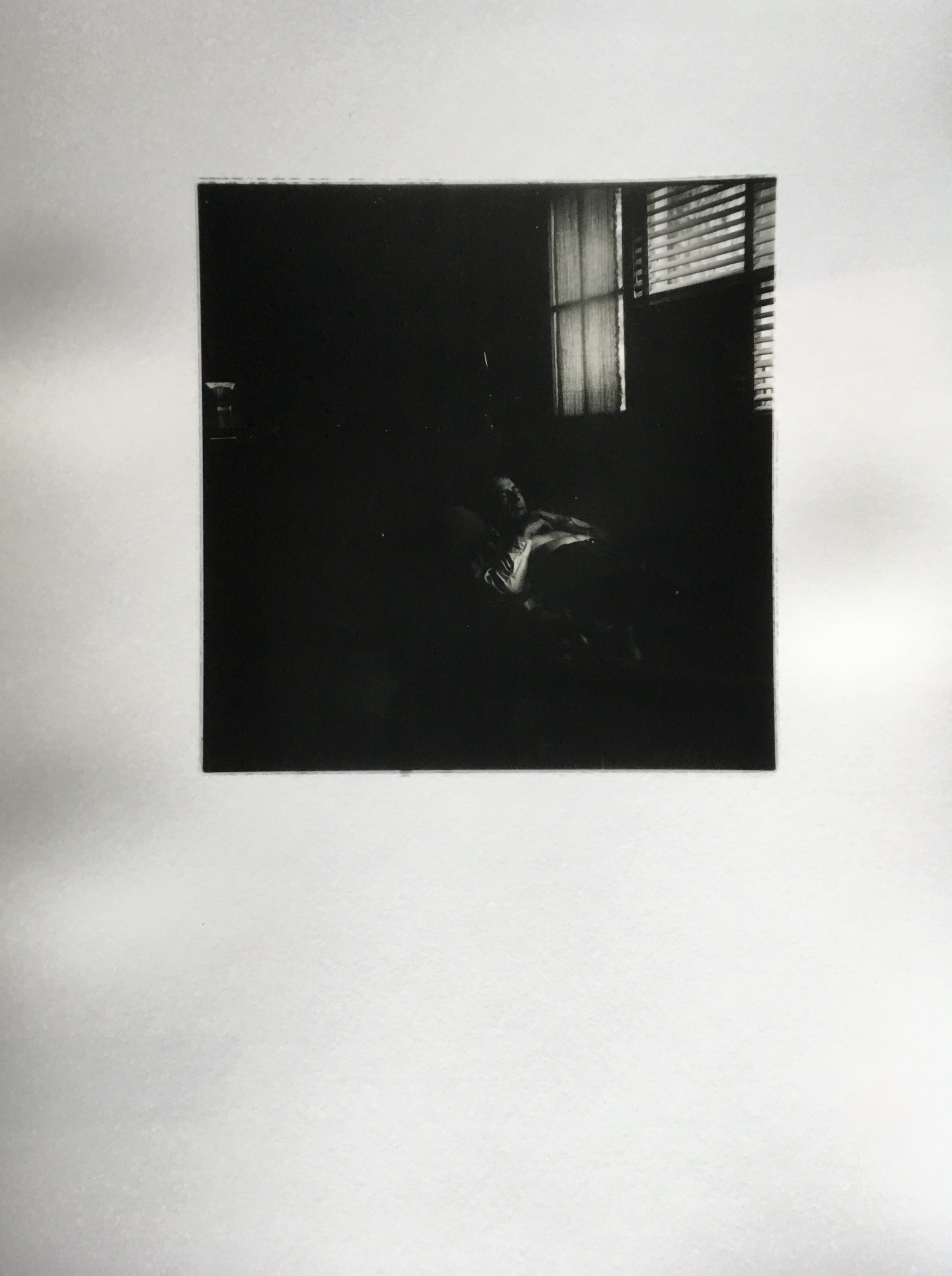

Got into the darkroom last night.
One of the first/earliest of my negatives. I've never printed this one before because it was just too thin. I never thought I could get anything out of it. My wife still thinks it's too dark and "why would you want a picture like that?"
But it's the old emotional excuse, it means a lot to me. Sure I have better pictures of my grandfather. Sure I have better pictures of my cabin. But I don't have any other picture of my grandfather taking a nap on the couch in the cabin living room.
The camera was my mom's Ricohflex, printed on MGIV with a blue filter and ND 0.6 to help keep print time reasonable (40 seconds). It was so dark on the easel I thought I might be able to use my infrared viewer to see what I was dodging. Turned out to be useless. (Maybe because the blue image had no red in it at all).
Thought I'd use a one-piece "L-shaped" dodger to brighten the windows a bit, but that lightened the black border making it obvious. So I made a smaller dodger shaped like the taller window and dodged 5 seconds in the middle of that window... then came in the side to the upper-right corner window for 5 seconds. I dodged the general area of my grandfather a few seconds as well.
One thing different about MGIV compared to Galerie, is the sheen of the glossy surface. It's a little more sheeny than Galerie. Not entirely unpleasant but just a bit.
