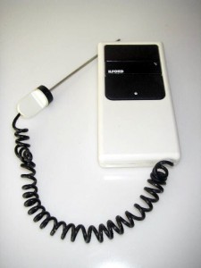

The old Ilford digital ones are quite good, and pop up on ebay quite often.

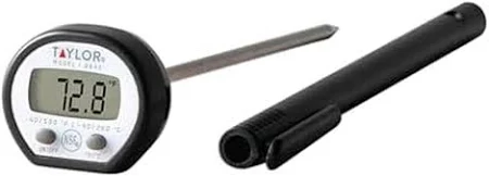

I use a cheap digital kitchen thermometer on a day to day basis, which I compare regularly against my Kodak Process Thermometer.
Works well for me, because it is reliable, inexpensive and easy to use.
Here is one with the same form factor:
