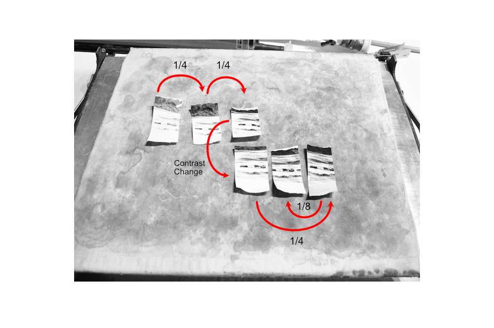

I have not used a conventional test strip (where each portion of the projected image gets a different exposure) since the early 1980s.
This shows an example of how I obtain the base exposure for a print. Each needs to be processed and dried to know how to proceed to the goal.
In the example I'm printing grade 5, so very tiny exposure changes are all that is needed (1/8th of a stop). If I were printing grade 0, then much larger exposure changes are needed.
1/4 = 1.4142140^.50 = 1.189
1/8 = 1.4142140^.25 = 1.091
