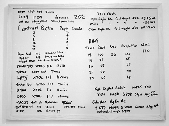

I recently added a whiteboard to my darkroom and have written all my 'need to know' bits if info on it. I took a picture of it in case someone decided to clean it, although I think it's time for a re-write!

Continuously repeat to myself, "Close the paper box, THEN expose the print... close the paper box, THEN..." :tongue:
Actually, I put up a cork bulletin board, originally to hold the paper to in the misguided and over ambitious attempt to do some horizontal enlarging... When that idea went out the window, it quickly became the posting area of:
Paper speeds, contact sheet exposures for max black, and all calculated dilutions for my trays.

I use a "white board" approach as well. If you scribble down the steps as you go, you don't have to rely on memory when doing multiple prints, developments, etc. tim

I love the white board idea.........
