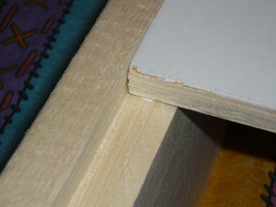

You don't need marine grade plywood or epoxy. I'm building my 3rd large darkroom that uses regular plywood and oil based paint for the sinks. I make my sinks out of 2x6" (1.5" x 5.5") lumber and 4x9 sheets of 1/2 nice plywood - about $40 a sheet.
I cut a notch in the 2x6 to hold the plywood bottom:
The ends are mitered - you need at least a 10" chop saw to do it but a 12" saw is better. Clamp and use 2.5" drywall screws to hold them together.
Screw the plywood into the frame using #6 screws 1.5" long. I run a bead of silicon caulk sealer in the notch to help seal it. Here's what they look like sitting on the 2x2 frame supports:

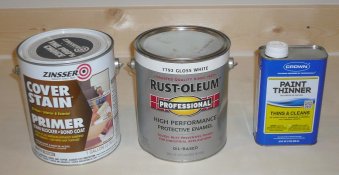

You MUST seal every seam with silicone caulk and let dry for at least 24 hours. Now use OIL based primer and paint:
I bought mine at Lowe's.
Use two coats of primer letting it cure for 24 hours in between coats. Then put on 3 coats of oil based paint, let dry 24 hours in between coats. After the last coat let it cure for 72 hours before using it.
