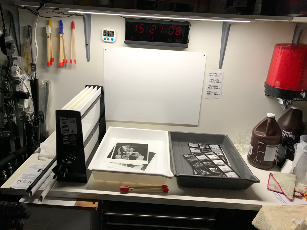

I use a single-bowl stainless kitchen sink in my darkroom. For film processing, I generally use a tray next to the sink to contain a water bath, film washing happens in the sink. For printing, I set up trays on a counter that's separated from the sink because of the room layout. I have a vertical print washer next to the sink opposite the tray, which drains into the sink, a tray with a syphon drain would work too.

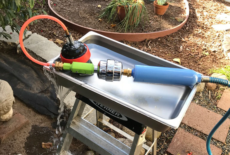

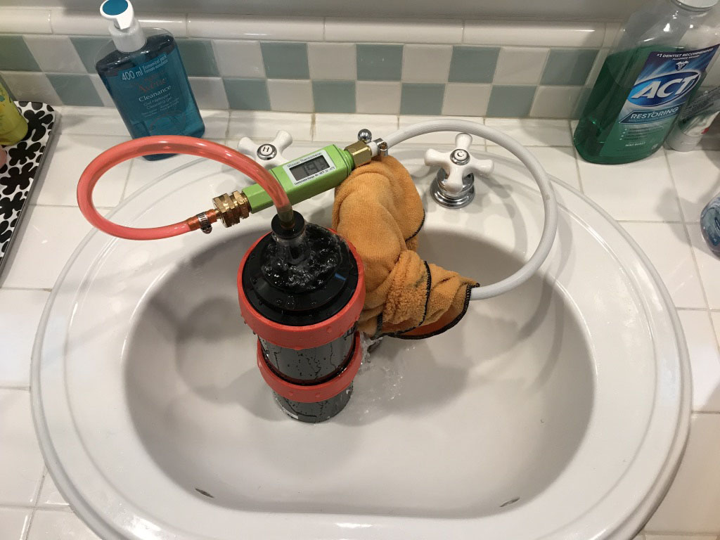

I assume you mean processing 4x5 film. You can get away with no sink at all, just empty used chemicals into a jug for later disposal. Washing can be done in a bathroom sink or even outside.

I should have mentioned this earlier, but I simply have a laundry room sink from the local home center. For washing large prints the tray hangs off the washing machine and an old Kodak siphon splashes into the sink. for 11x14 and smaller I have a print washer that sits on a shelf and drains into the sink.
